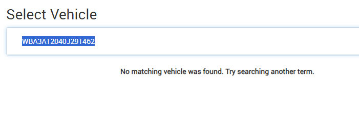

I asked about flushing it because if it was dirty enough, it may have allowed sludge to enter the solenoids and prevented them from operating properly. I would at a minimum inspect them to see if there is evidence of blockage.
Also, I tried looking up the VIN and my manual says there is no match. See pic below.
Let me know your thoughts on the solenoids. I suspect that is where the problem is coming from.
See pic below.
