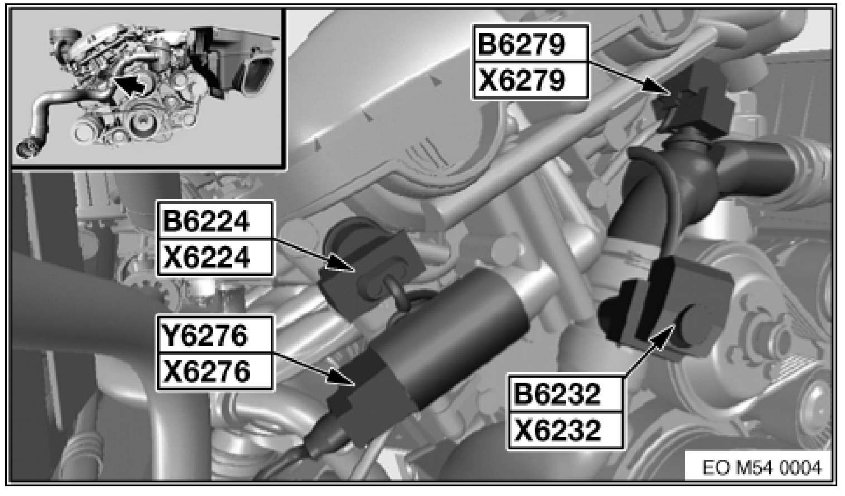

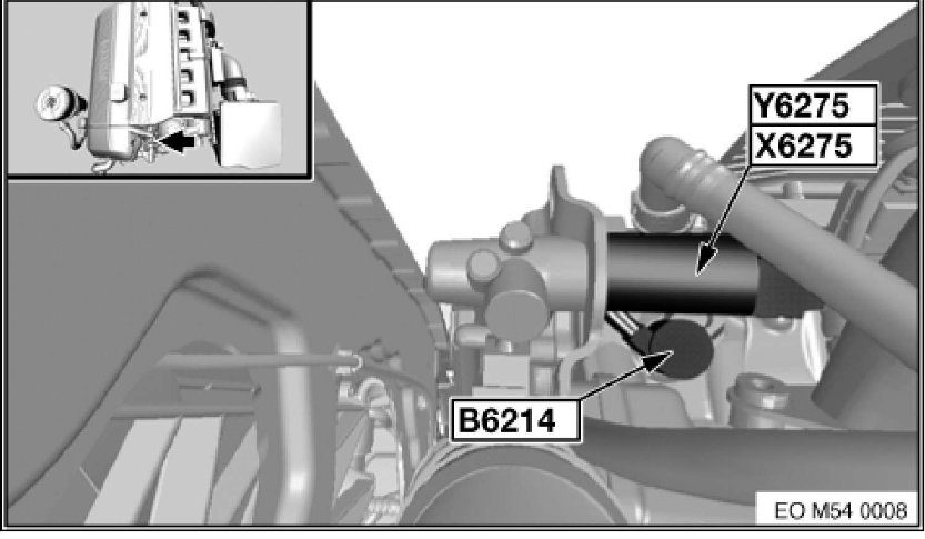

Car listed above is a e85. where is the camshaft sensor?

Hello, I'm Danny.
Your car has 2 camshaft position sensors, 1 for the intake and the second for the exhaust.Here is a tutorial showing how to replace a camshaft sensor:
https://www.2carpros.com/articles/camshaft-angle-sensor-replacement
I've attached 2 pictures below of their location. First picture is intake and second picture is exhaust.Hope this helps and thanks for using 2CarPros.
