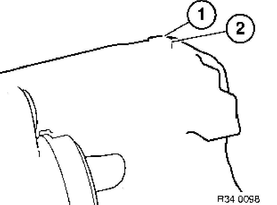

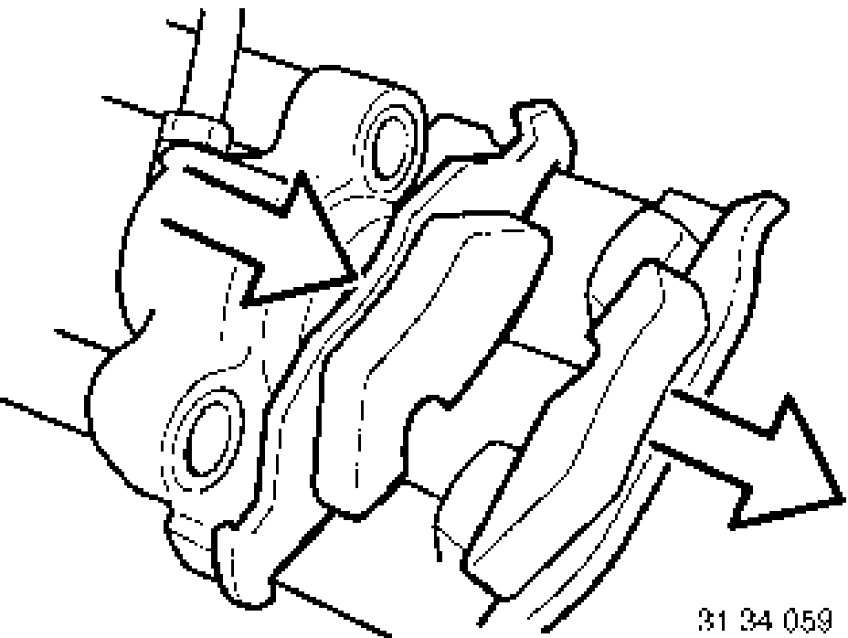

Remove wheels.
pic 1
Lift out retaining spring (1).
Left:
Disconnect plug connection for brake lining wear sensor.
If necessary, replace brake lining wear sensor.

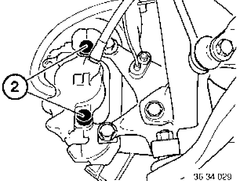

Remove plastic plugs (2).

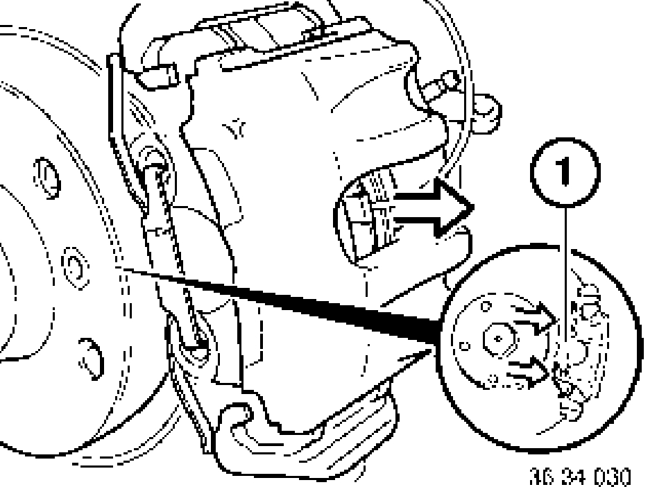

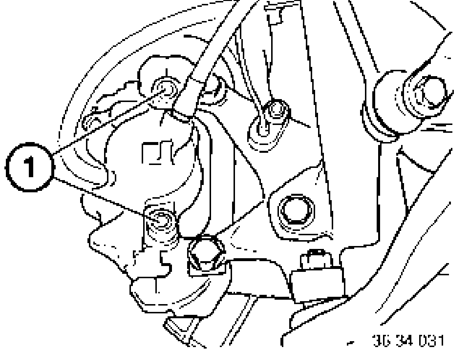

pic 3
Unfasten guide screws (1) and lift out brake caliper towards rear of vehicle. Do not allow brake caliper to hang from brake hose, risk of damage to brake hose.
Installation: Only clean guide screws; do not grease.
Check threads.
Replace all guide screws which are not in perfect condition.

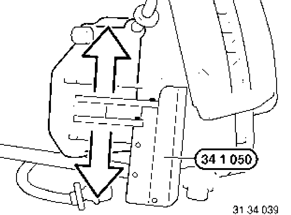

pic 4
Turn piston fully back with special tool 34 1 050.
Important:
When turning back the piston, watch the brake-fluid level in the expansion tank, as overflowing brake fluid will destroy the paintwork.

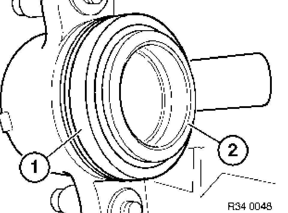

pic 6
Check dust sleeve (1) for damage and replace if necessary.
Clean contact face (2) of brake piston and apply a thin coating of anti-squeak compound.
Anti-squeak compound, refer to BMW Service Operating Fluids.
Important: Dust sleeve must not come into contact with anti-squeak compound as this may cause the dust sleeve to swell.

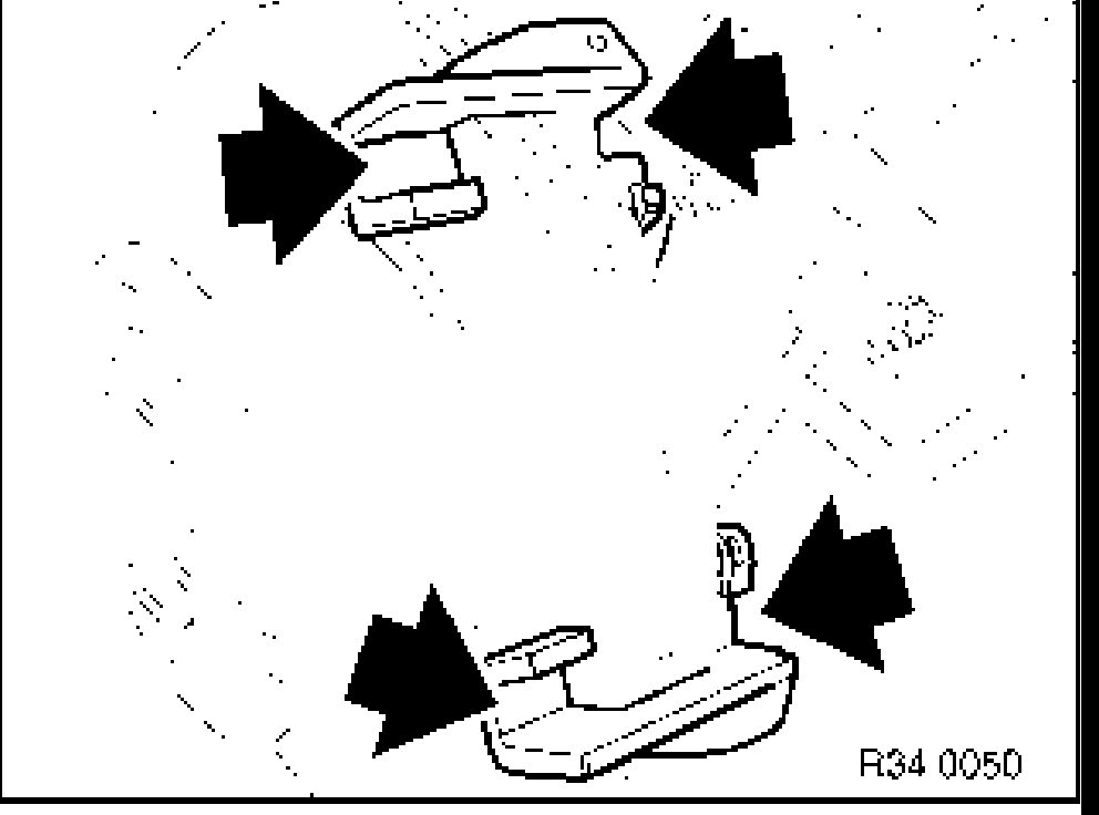

pic 7
Clean contact faces (1...2) of brake lining hammer heads/brake caliper housing and coat with anti-squeak compound.

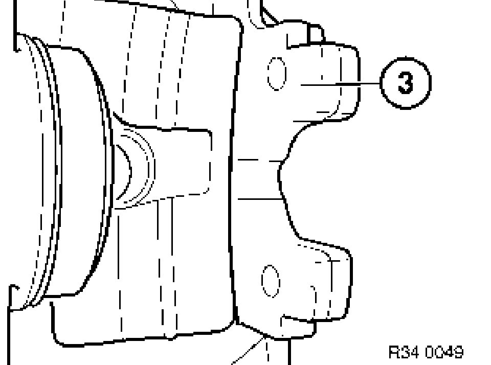

pic 8
Clean contact face (3) of brake caliper and apply a thin coating of anti-squeak compound.
pic 9
Clean contact face of brake caliper mounting bracket and apply a thin coating of anti-squeak compound.
