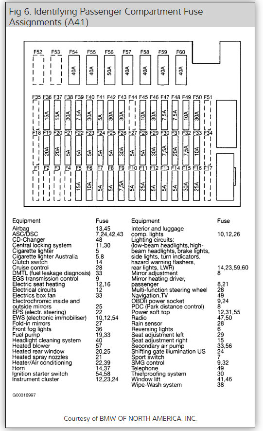

where is the fuse 61 in the car
2004 BMW Z4
MAURICIO TANUZ
Six cylinder two wheel drive automatic.
I have an AC issue and looking at the electric diagram shows a fuse # 61. I cannot find it. Would you help me because my AC is not working?
Jun 18, 2009 at 5:05 PM
MAURICIO TANUZ

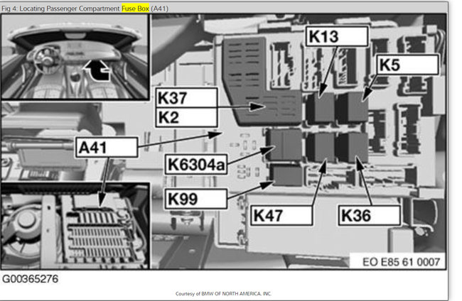

I do have one actually Haynes and it shows the fuse into the diagram, but it does not show it the location in the car, and into the fuse box just comes the # 60. Please would you help?
Jun 18, 2009 at 5:12 PM
  • 54,861 POSTS

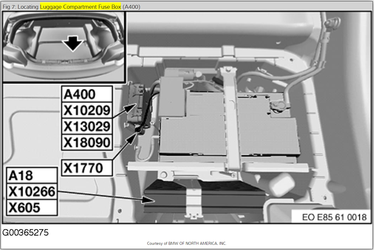

The fuse 61 is back by the battery. Here are the fuse panel locations and identification:
May 7, 2018 at 1:34 PM
