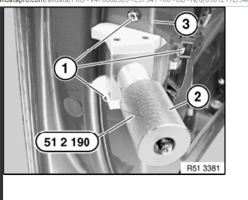

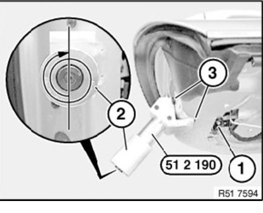

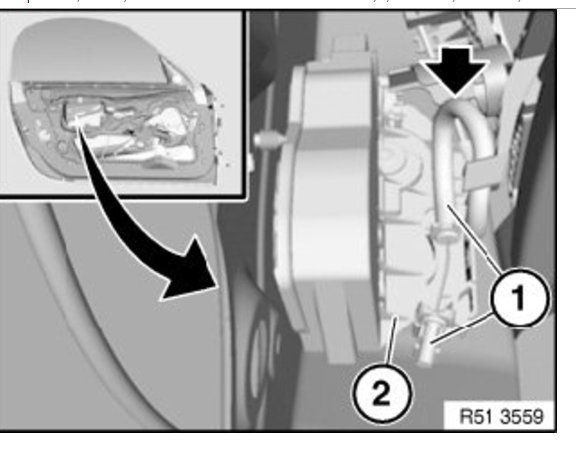

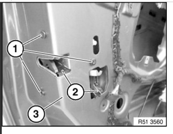

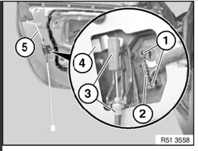

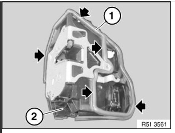

My drivers door is stuck shut. The central locking works and opens the passenger door, using fob and internal switch. But my drivers door is stuck shut. Also my drivers window does not work.
Any help would be great, this site rocks
Jun 13, 2009 at 3:32 AM
  • 54,861 POSTS
It sounds like one of two things could have happened, first you will need to remove the door panel which means the drivers seat, Here is a guide that will give you an idea how to remove it.
https://www.2carpros.com/articles/door-panel-removal
Once the door panel is off look for a lock rod that has fallen off of the lock arm of the latch.
Here are some diagram (below) on what it is on your car.
Second is the latch itself has fallen apart and will need to be replaced. This can be rough since the latch will need to be taken apart inside the door.
Please let us know what happens, we are interested to see what it is.
