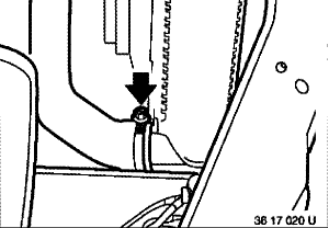

Hello -
Here you go. . .. . .. . ...good luck
Caution:
Danger of scalding
Only open sealing cover on expansion tank when engine has cooled down.
Drain coolant, refer to Cooling System - Service and Repair - Procedures See: Service and Repair
Remove fan cowl, refer to Fan Shroud - Service and Repair - Procedures See: Fan Shroud Service and Repair
Note: When removing the fan cowl, note the engine variant.
https://www.2carpros.com/forum/automotive_pictures/248015_R1_1.gif
Air conditioner
Disconnect plug connection on temperature switch.
https://www.2carpros.com/forum/automotive_pictures/248015_r2_1.gif
Disconnect upper water hose.
https://www.2carpros.com/forum/automotive_pictures/248015_r3_1.gif
Disconnect lower water hose.
https://www.2carpros.com/forum/automotive_pictures/248015_r4_1.gif
Disconnect expansion hose.
https://www.2carpros.com/forum/automotive_pictures/248015_r5_1.gif
Automatic transmission
Remove transmission oil cooler lines, catch transmission oil as it escapes and dispose of correctly.
Installation:
Check transmission oil level and correct if necessary, refer to Transmission and Drivetrain.
Check connection for leaks.
https://www.2carpros.com/forum/automotive_pictures/248015_r6_1.gif
Unfasten left and right radiator mounts by pressing detent down with screwdriver.
https://www.2carpros.com/forum/automotive_pictures/248015_r7_1.gif
Sectional view of radiator mount:
Screwdriver
Front trim
Retaining lug for radiator
https://www.2carpros.com/forum/automotive_pictures/248015_r8_1.gif
Installation: Attach retaining lugs in left and right sides of radiator and press down firmly. The detent must engage audibly several times.
https://www.2carpros.com/forum/automotive_pictures/248015_r9_1.gif
Installation: Use screwdriver to locate and lug of radiator mount and to tighten the unit.
https://www.2carpros.com/forum/automotive_pictures/248015_r10_1.gif
Lift radiator upwards (together with intercooler if applicable).
Installation: Place radiator on supports.
https://www.2carpros.com/forum/automotive_pictures/248015_r11_1.gif
Installation: Note rubber mounts on left and right sides.
