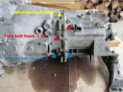

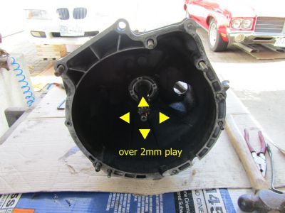

I pulled the transmission to put in new clutch kit - everything looks good except significant lateral play at the end of transmission input shaft. Wacking with the heeel of my hand, I swear that is the kind of sound I was hearing. Front pilot bearing seems very good, clutch disc is a bit rattly & loose, but lots of meat on it. I don't mind changing out the clutch (I have an upgrade conversion kit - to single mass flywheel) but I sure don't want to put all of this back together to have same problem.
I suspect (hope) I just need to replace input shaft main bearing and seal, but there is also an inner race bearing (tapered?) per the BMW parts picture I have. I can't find any proper exploded view of this tranny, I've never been inside a transmission before. Anything more than the input shaft bearings may be more than I can handle properly.
I pulled the bolts to separate the front bell housing from the main gearbox, won't separate. There's a couple of Torx head bolts and one allen head bolt that look to hold internal linkages or such, they look like they may span the separation line. - if I pull these do I drop stuff inside and get into a real jam?
Any help, a proper diagram for the exact xmission would be REALLY good. Getrag S5D 250G.

OK you two... thanks to both for your quick replies. The locator dowels are in place and fine. Tech bulletin likely not applicable in this case. Doc, I believe the noise is internal tranny. I am concerned with the lateral play on the unsupported input shaft (when removed from pilot bearing). See photo, is this reasonable play?
https://images.2carpros.com/forum/automotive_pictures/569400_96_Z3_Getrag_input_shaft_lateral_play_2.jpg
The output shaft is tight, no lateral or end play, seems good. All clutch and transmission functions were good except for the chatter & clacking in neutral with clutch engaged, as well as the slap clack sound with rapid loading and unloading tranny. (I could make this happen consistently in first gear, slow speed, and throttle & clutch play to rapidly change the tranny from loaded to unloaded to loaded.) Sure sounded like the same kind of sound I can make slapping the free end of the input shaft. The link to diagrams is very helpful, looks like I will be releasing some linkage in separating the front and rear housings. See photo, I am guessing these need to be disconnected to separate.
https://images.2carpros.com/forum/automotive_pictures/569400_96_Z3_Getrag_separation_bolts_sml_mrkup1_1.jpg
. I do have a great mechanic available next week for back-up, but if I never take on a tranny I'll never learn. Any additional pointers would be appreciated. I'll post results also. Dave

You are quite possibly chasing a noise generated from the single mass flywheel. The reason BMW uses a dual mass flywheel is for noise suppression in the gearbox. I am sure I did not realize this fact in your initial post and I apologize for sending a false or misleading statement.

For now, may I ask for one last opinion that hasn't been answered? I am still concerned about the lateral play on the input shaft - is the amount of play reasonable?
The shaft has 2 bearings inside the tranny case, shouldn't the free end be solid as a rock? I seems to me that the pilot bearing is not intended to pick up slack.

The input shaft depends on the pilot bearing to hold it in position, the movement of the input shaft when compared to other transmissions is normal, or as we used to tell `em, "They all do that"
