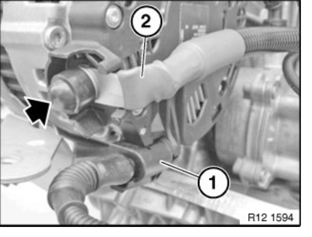

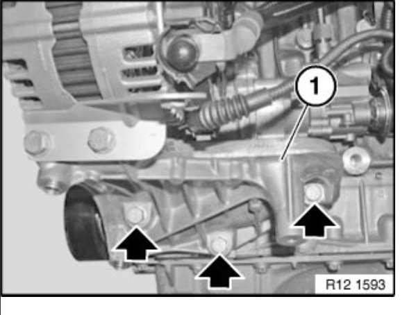

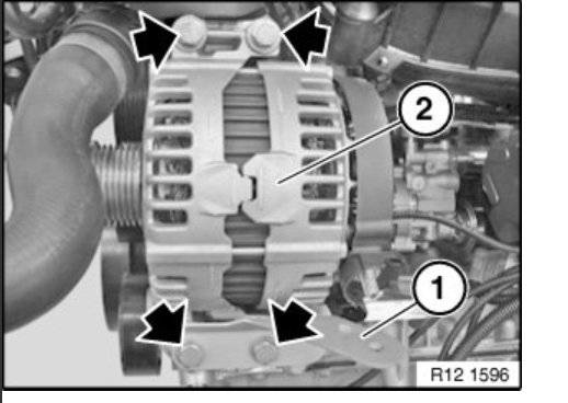

It sounds like the alternator is out and needs replacement.
Here are a couple of guides to help confirm the problem so you can get it fixed:
This will give you an idea of what you are in for when changing the unit.
https://www.2carpros.com/articles/how-to-replace-an-alternator
Clear the codes once you are done.
https://www.2carpros.com/articles/check-engine-light-clear-codes
