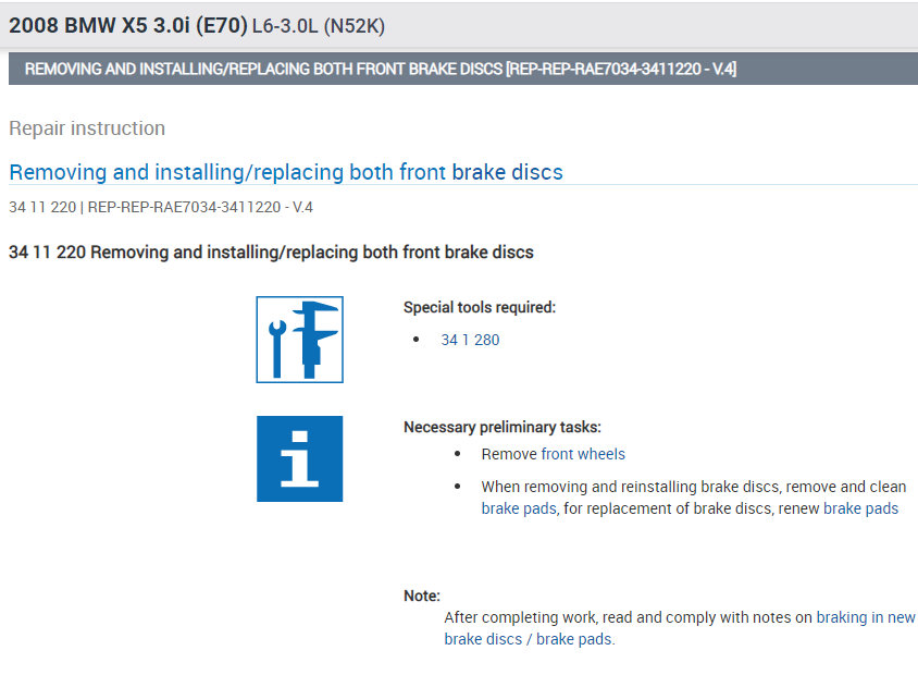

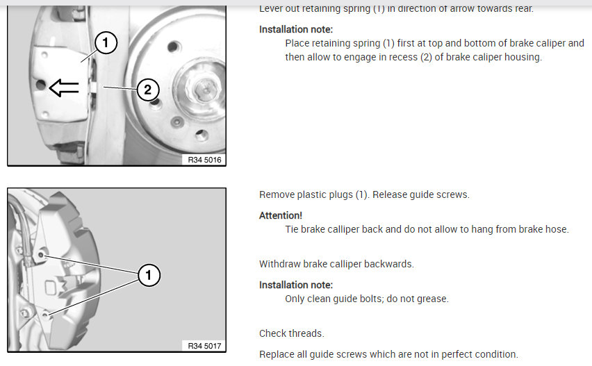

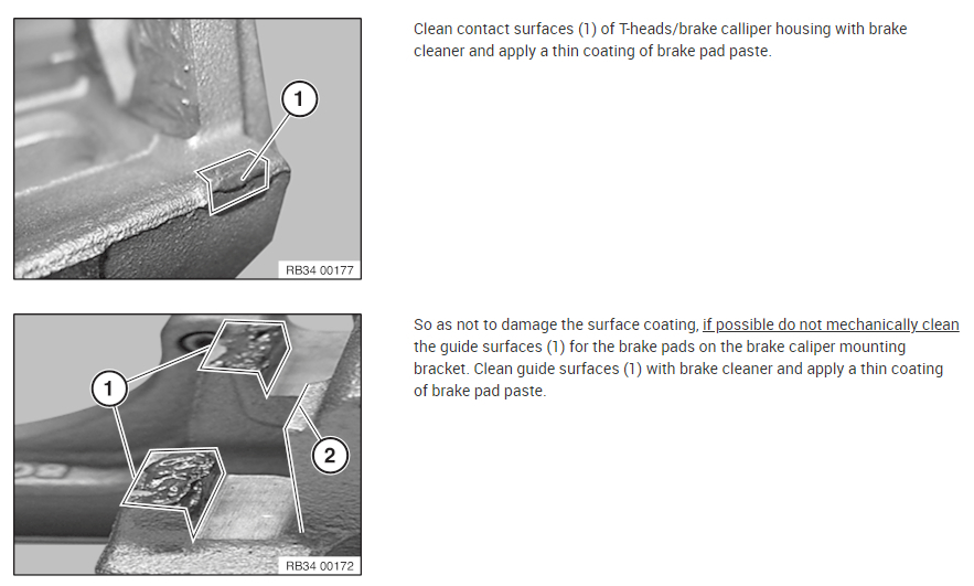

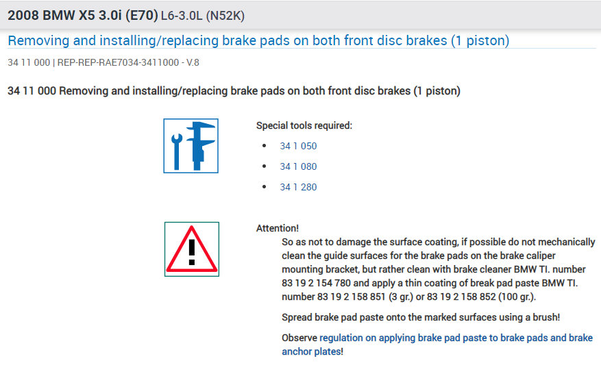

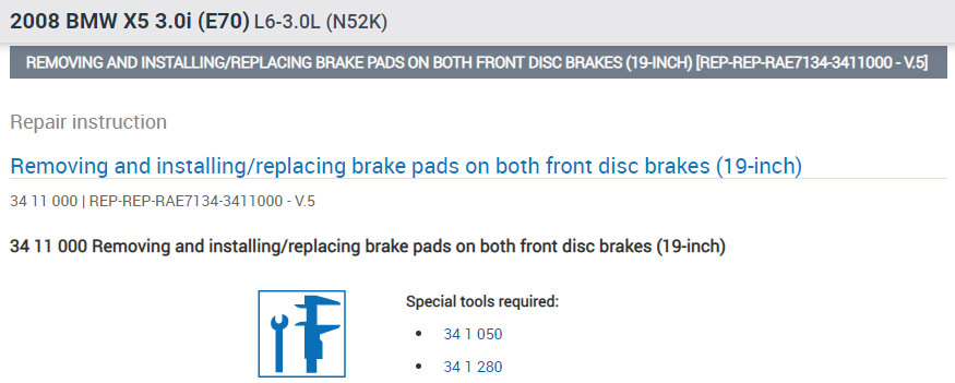

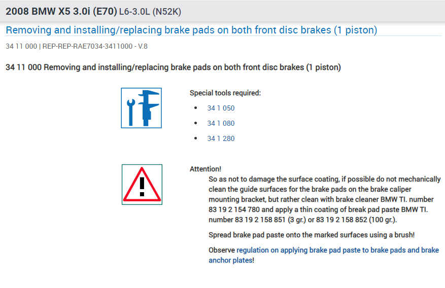

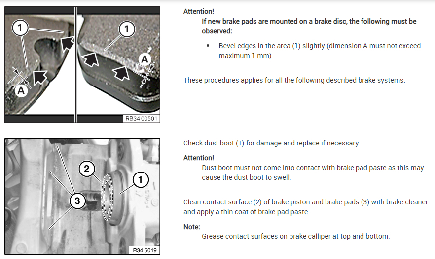

hi, I need to save money by doing the brake myself can you help me please?
Feb 19, 2010 at 1:15 PM
DANNY L
  • 5,648 POSTS
Hello, I'm Danny.

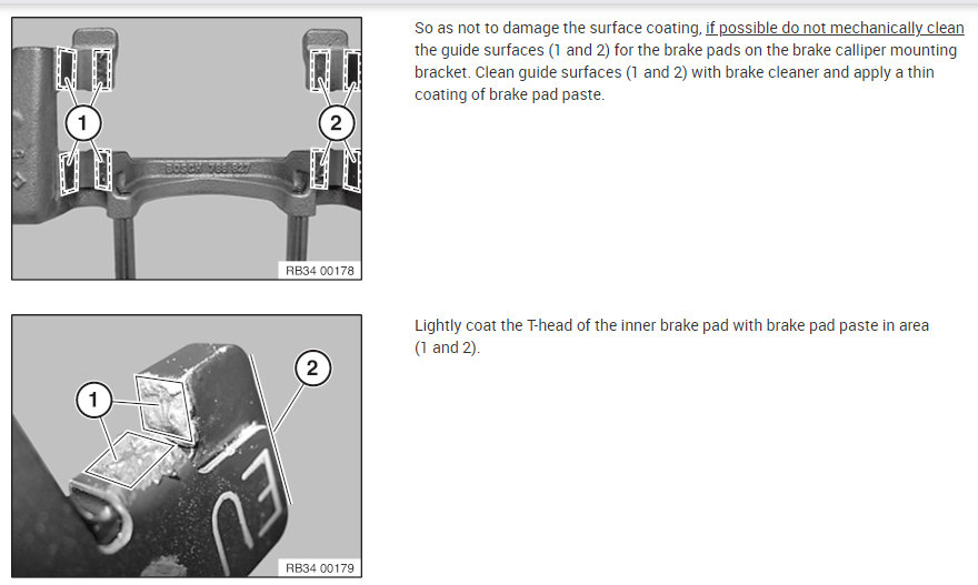

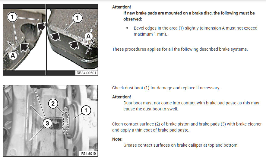

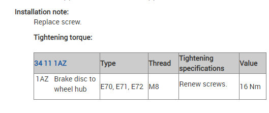

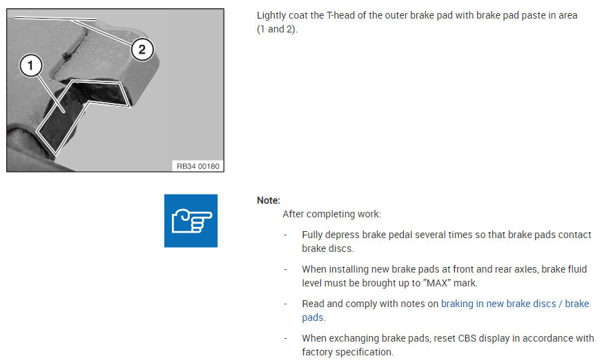

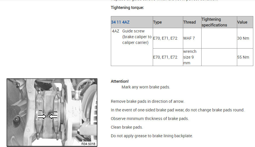

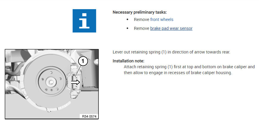

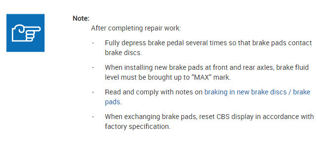

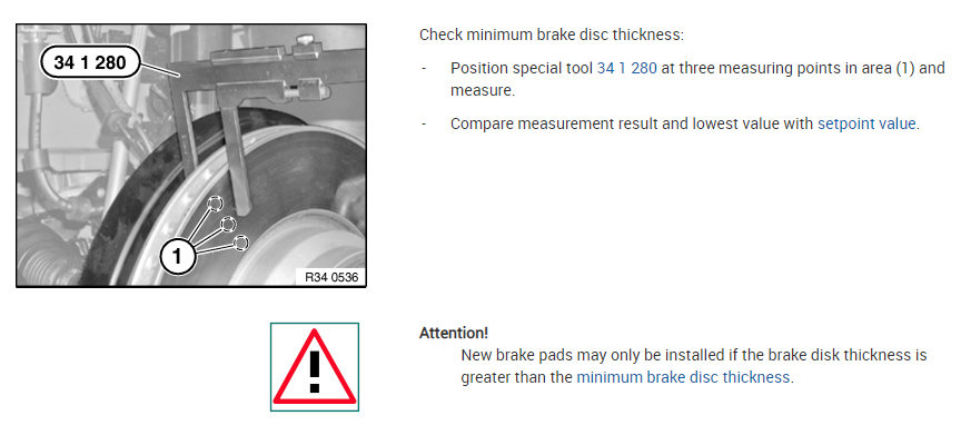

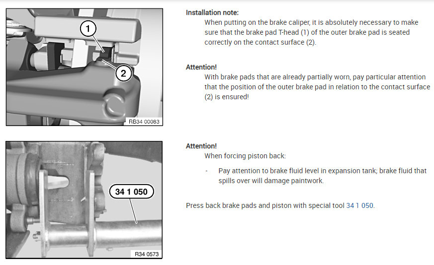

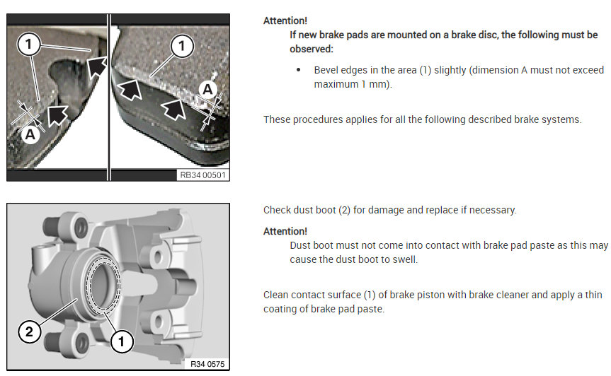

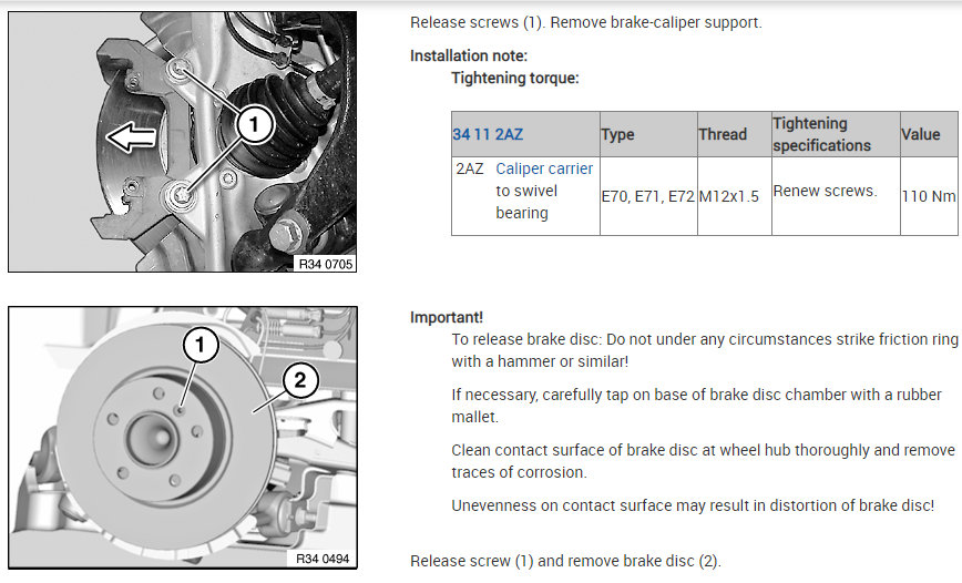

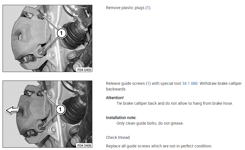

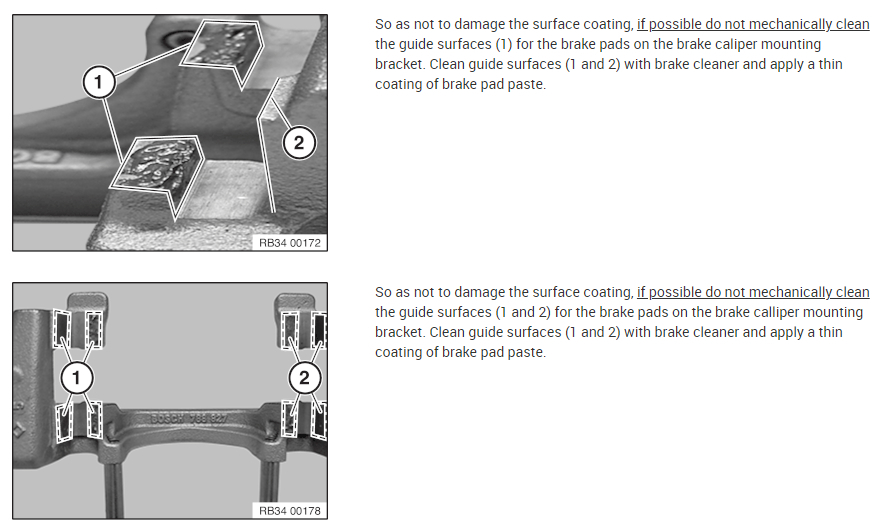

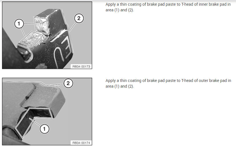

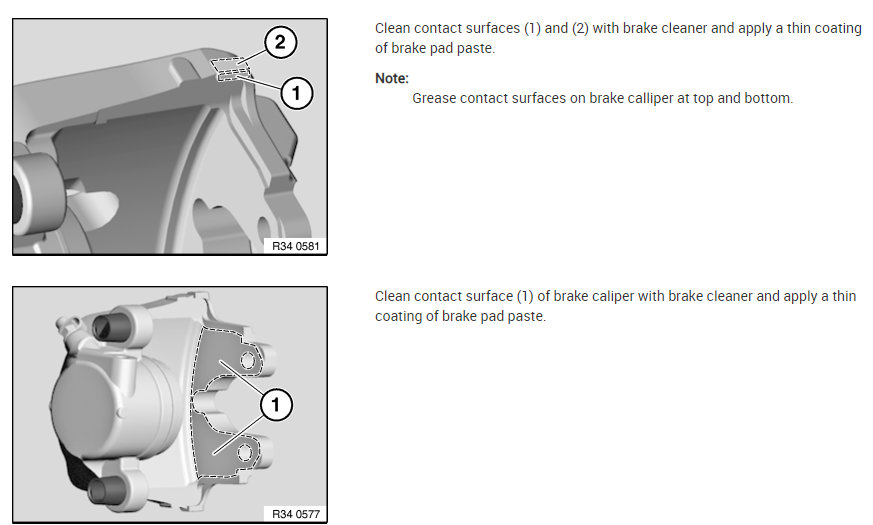

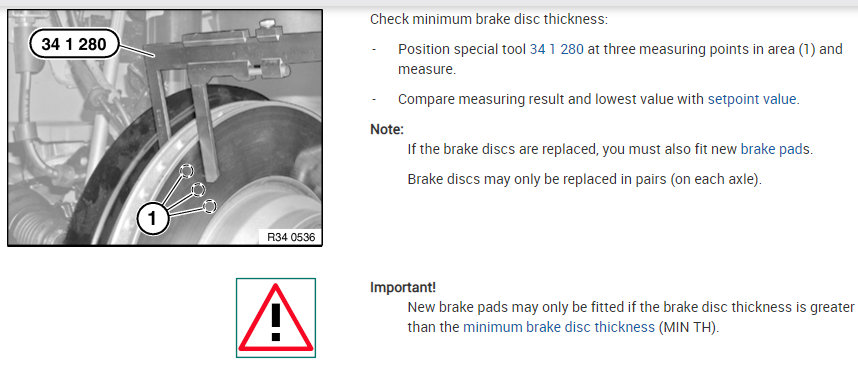

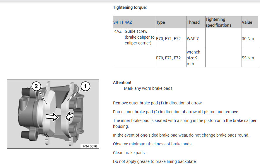

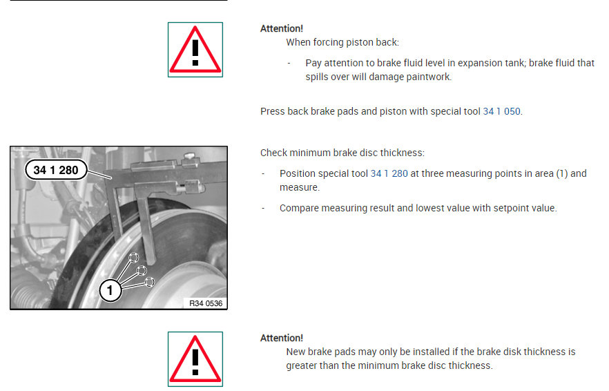

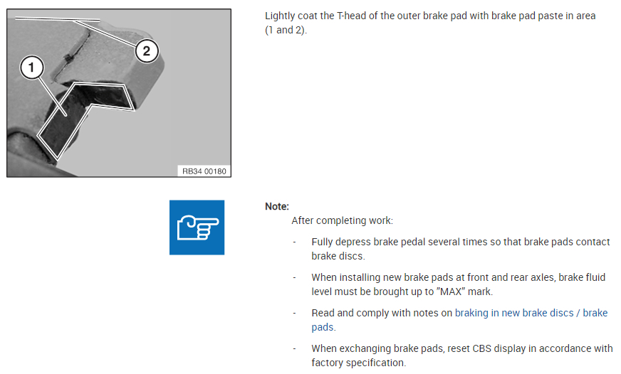

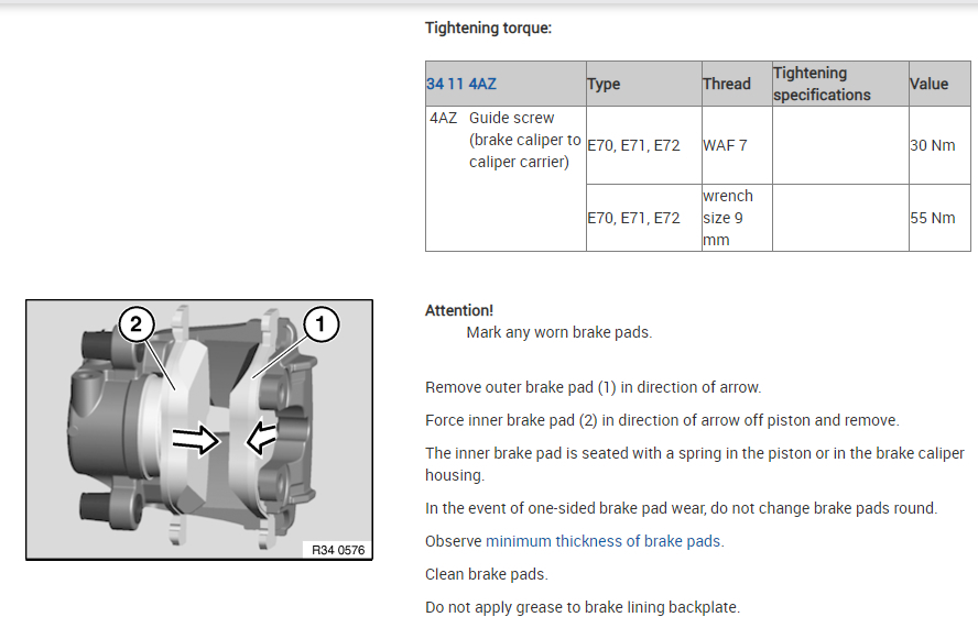

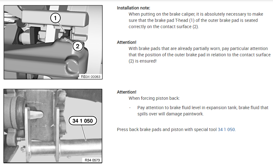

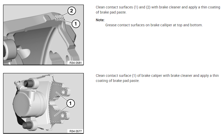

Here is a tutorial to get you started on how to change front brakes and rotors. Here is a guide to help you step by step with instructions in the diagrams below to show you how on your car.
I've attached picture steps below on how to change the front brake pads and rotors on your car. I've included both single and dual piston versions. Hope this helps and thanks for using 2CarPros. Check out the diagrams (Below). Please let us know if you need anything else to get the problem fixed.
