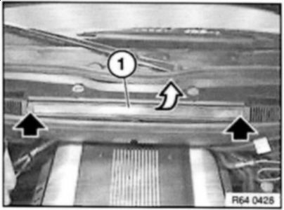

Where is the cabin air filter and how do you replace the filter
Jan 29, 2010 at 11:49 AM
  • 75,992 POSTS
2005 BMW X5 (E53) L6-3.0L (M54) Cabin Air Filter
https://images.2carpros.com/forum/automotive_pictures/12900_cafbmw_1.jpg
Replacing Microfilter For Interior Ventilation
https://images.2carpros.com/forum/automotive_pictures/12900_cafbmw1_1.jpg
*Turn toggle through approx. 90 ° and open cover (1)

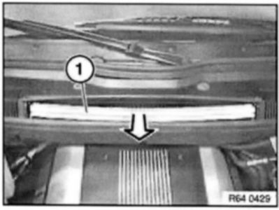

https://images.2carpros.com/forum/automotive_pictures/12900_cafbmw2_1.jpg
*Pull out microfilter for interior ventilation (1) in direction of arrow.
