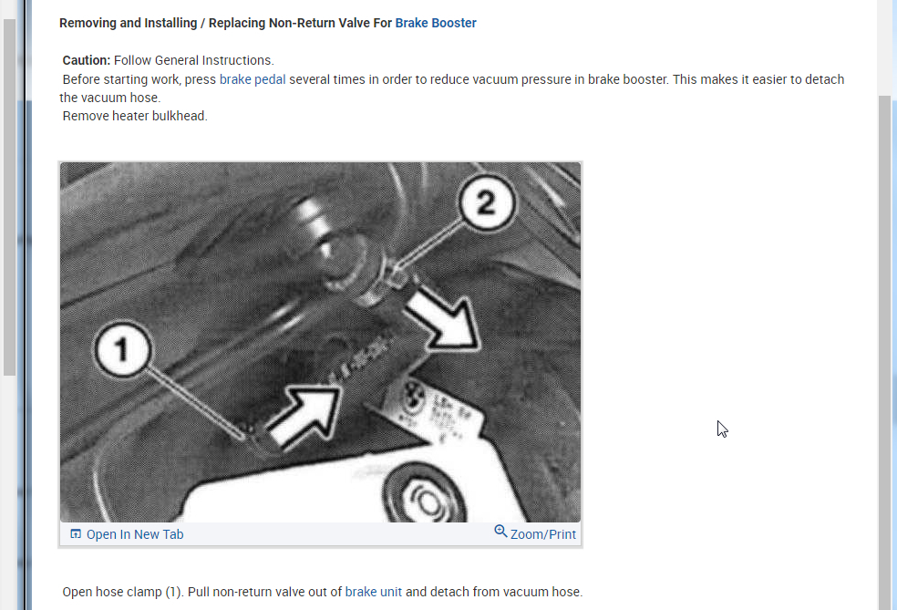

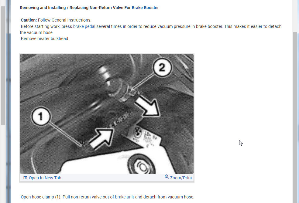

i have fit new pads now I hear a hissing from under the dash.
Dec 20, 2007 at 3:47 PM

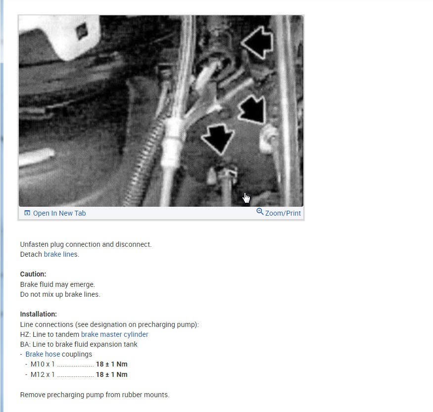

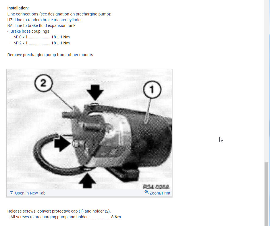

This does sound like a brake booster issue so below is the info for the process from the manual. Check out the diagrams (Below). Please let us know if you need anything else to get the problem fixed. Please let us know if you have other questions. Thanks
