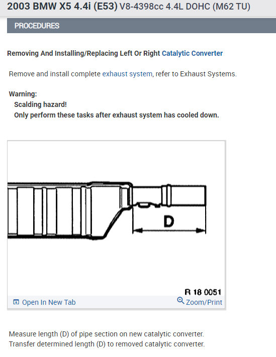

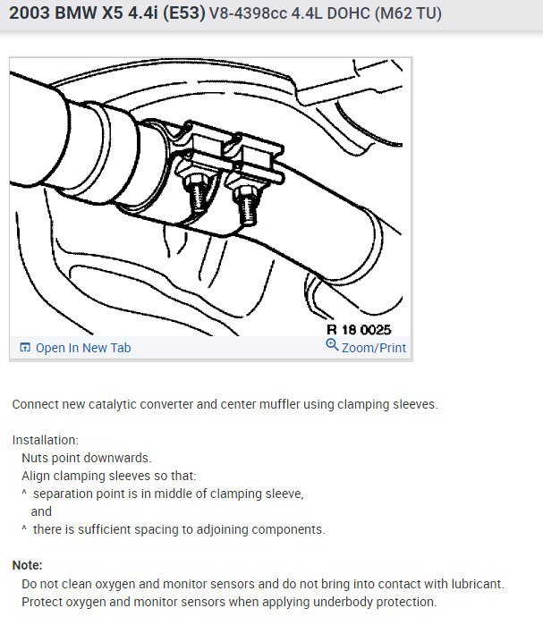

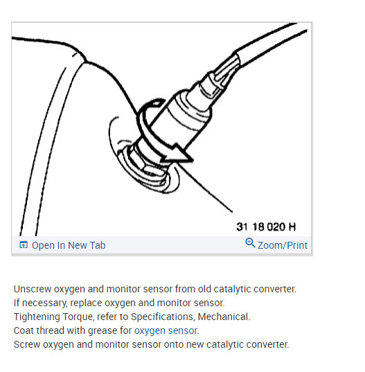

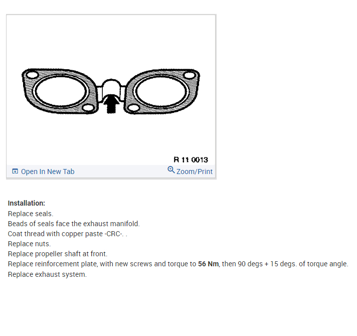

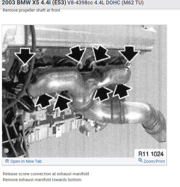

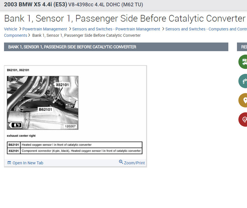

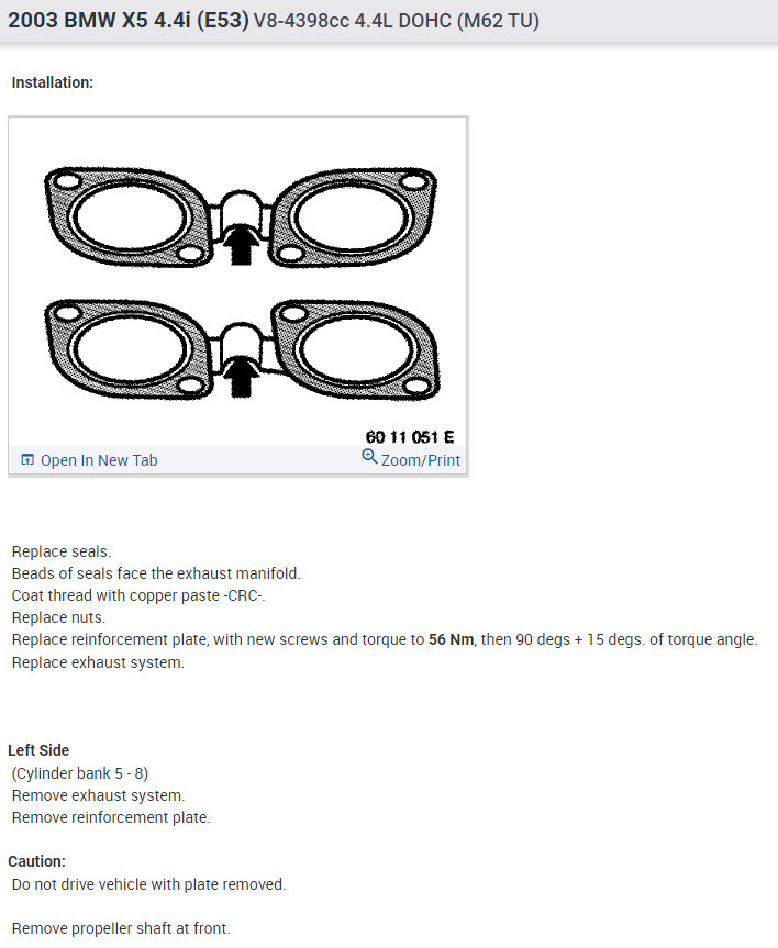

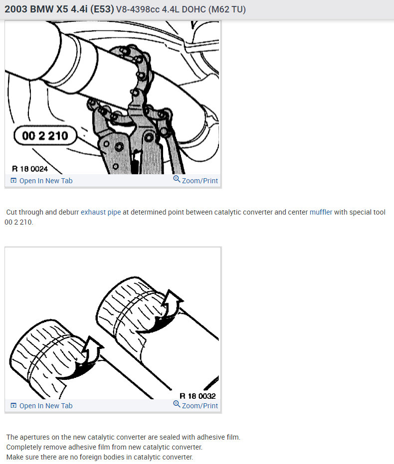

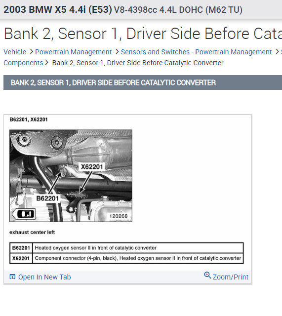

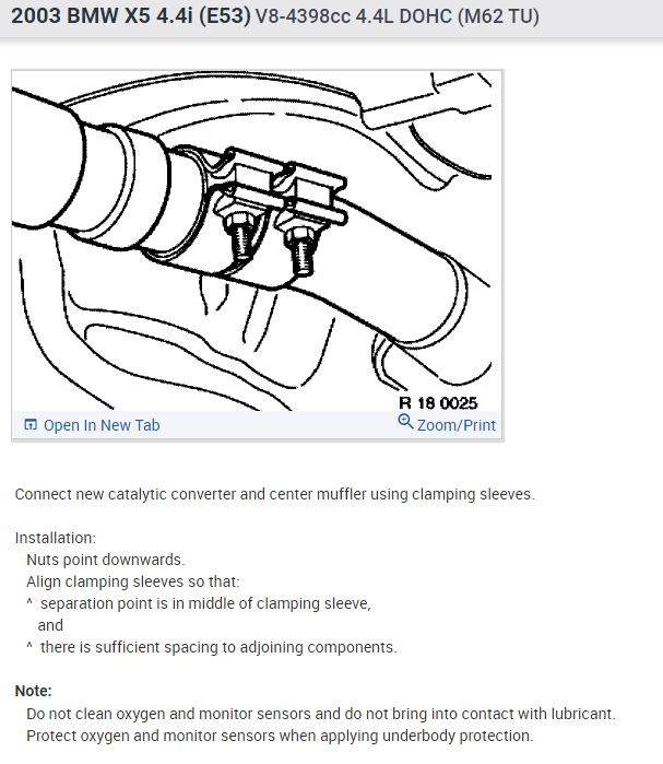

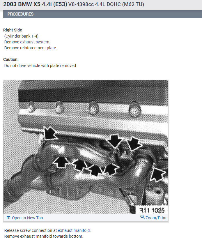

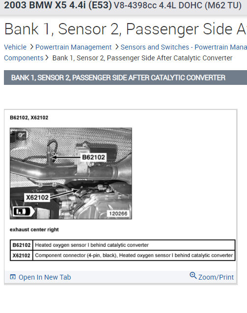

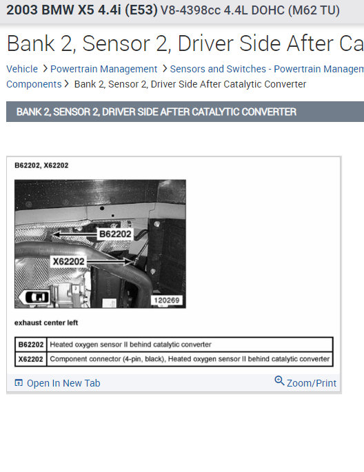

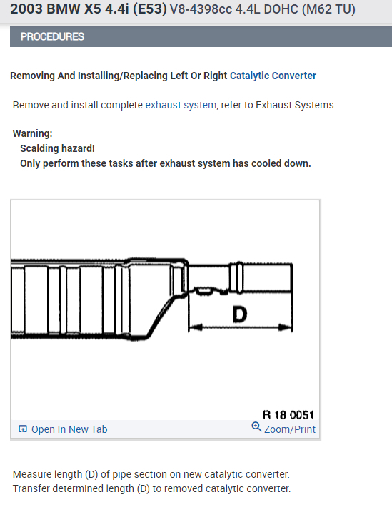

Hi, how can I change the O2 sensor and the catalytic converter and after that how can I tell there is no further problem that I need to work on. Thanks
Mar 10, 2008 at 1:00 PM
SQM
  • 6,383 POSTS
Before you get started you want to make sure that the engine is cool.
Raise and support the vehicle with jack stands.
You will have to remove the drive shaft in order to get the converters out.
https://www.2carpros.com/articles/catalytic-converter-replacement
To make the removal of the oxygen sensor easier, you will have to use a oxygen sensor socket.
https://www.2carpros.com/articles/how-to-replace-an-oxygen-sensor
I have attached replacement procedures for the catalytic converters as well as the oxygen sensor.
