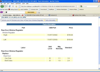

Hi: Could you give me an estimate of what you might think the charge would be to fix the back window of a BMW X5. I believe it just popped off the track. I was putting it up from the drivers seat side and I heard this pop and the window dropped down into the window well.

First of all thank you so much for your donation.What i think happened is your rear window regulator broke they usually don't just pop off track for no reason.Without looking inside the door to see what happened that's my best guess.The regulator is 157 plus tax and the labor to replace it is 1.6hr's time's shop labor rate 80-100 per hr?The labor rate all depends on where you take it too.
