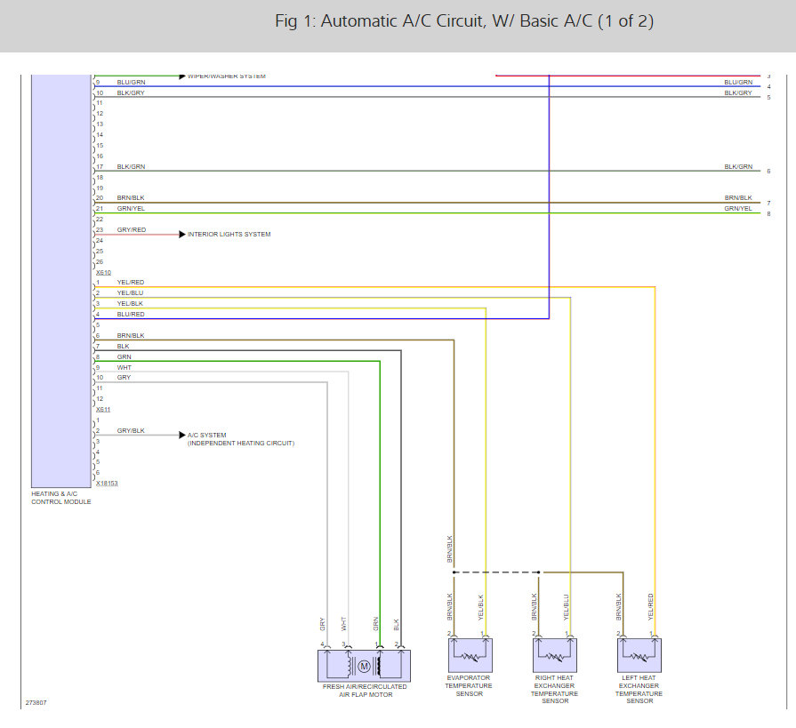

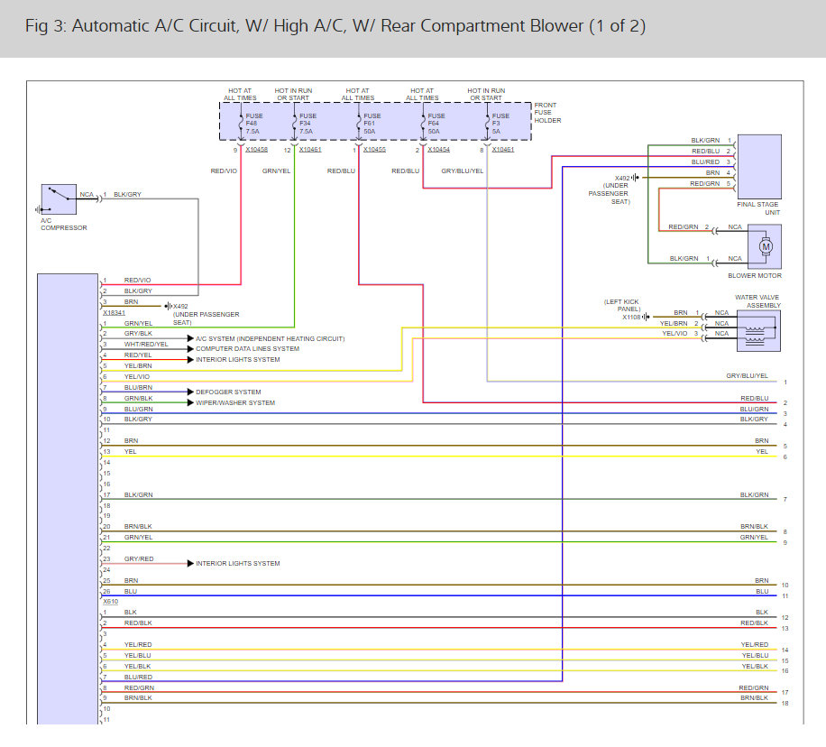

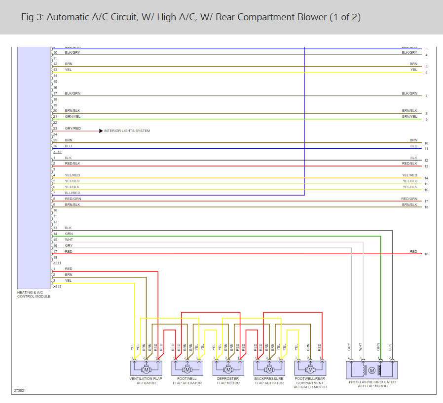

Climate control system completely stopped working. No heat, no A/C, no fan for front and rear vents, and control panel display is not on at all. I checked fuses and there are no issues. Could a faulty final stage unit be the cause for all of these problems, including the control panel display not working?
Dec 24, 2009 at 11:33 AM
DOCHAGERTY
  • 9,606 POSTS

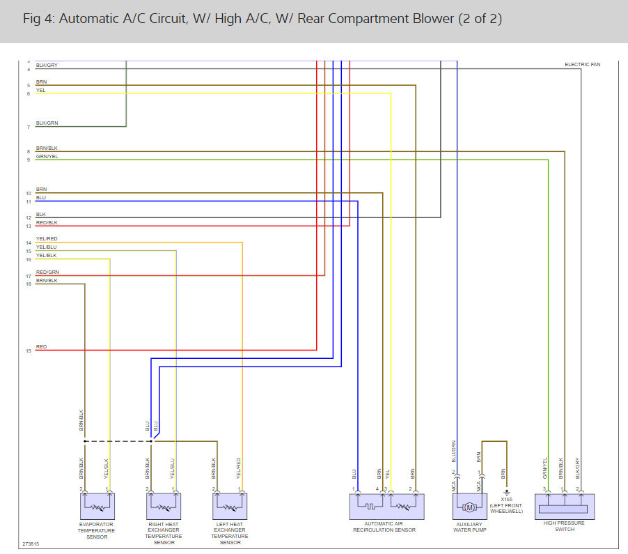

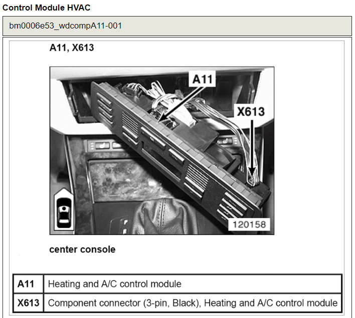

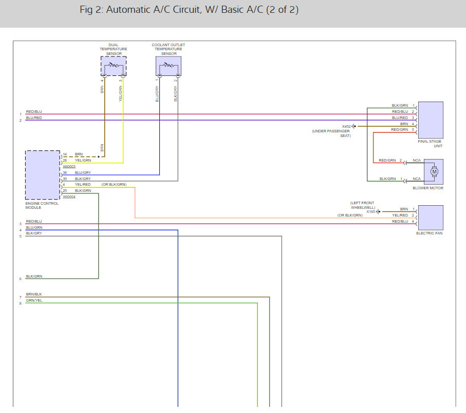

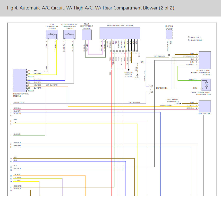

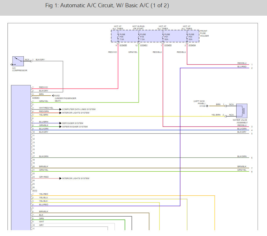

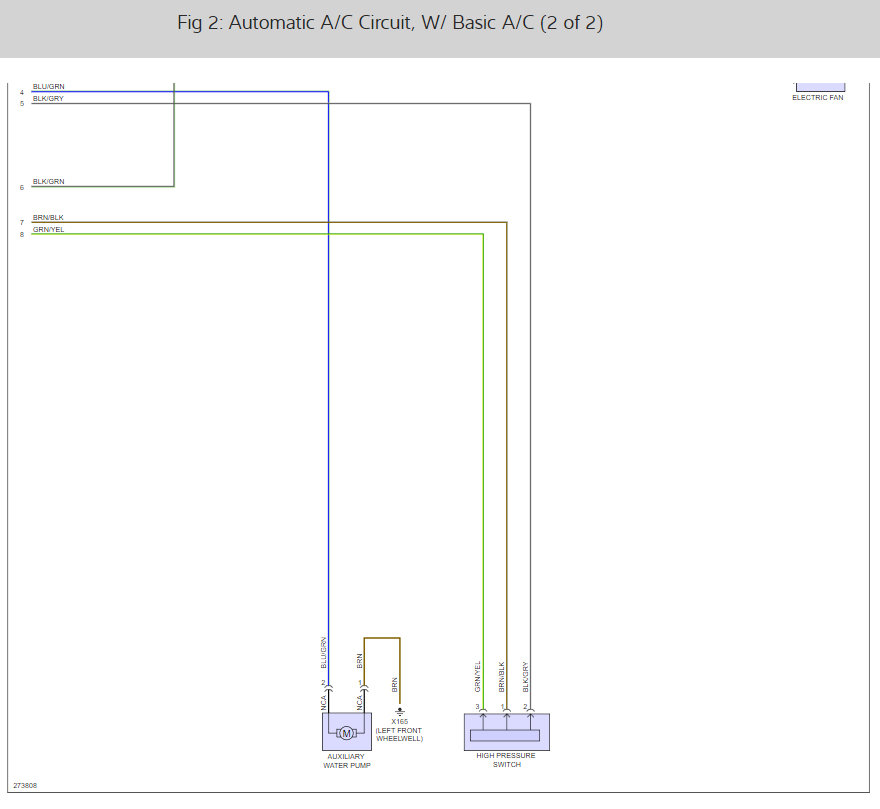

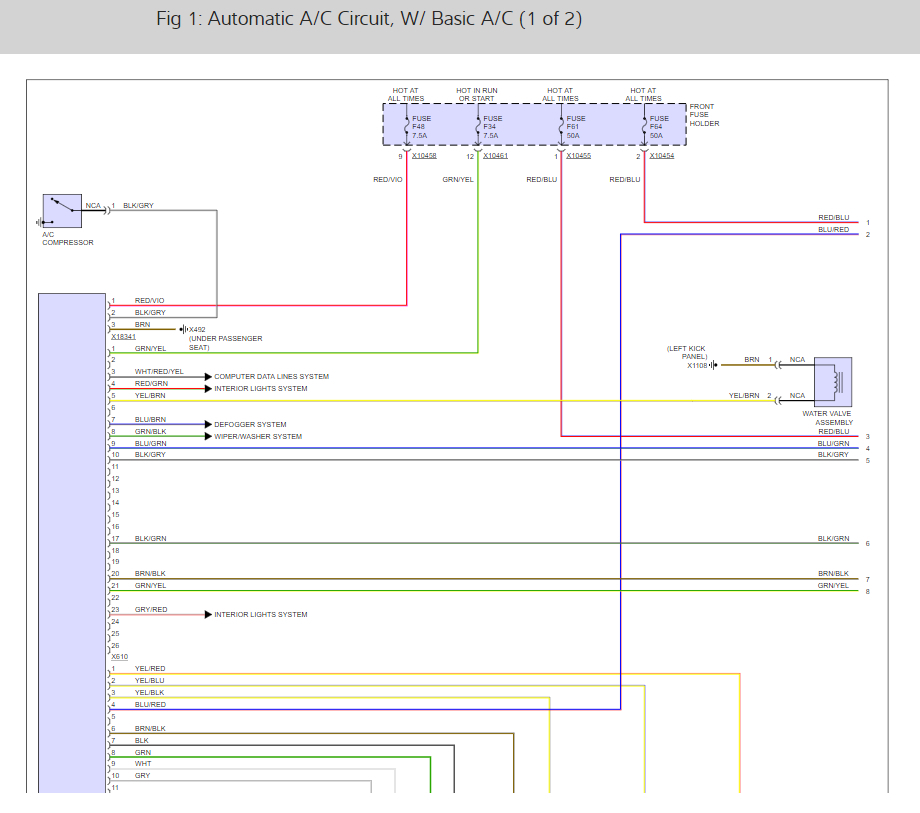

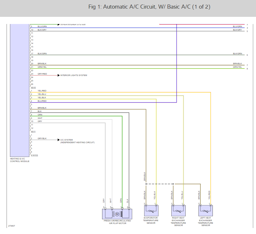

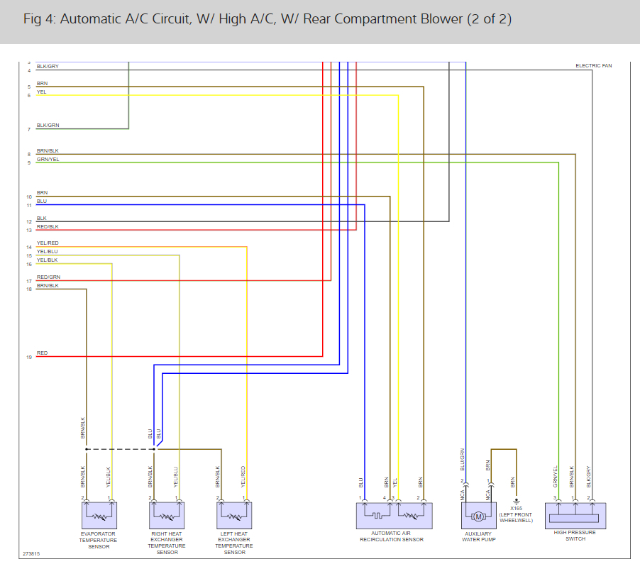

This does sounds like the control head, but to be sure let's check the power and grounds of the unit. Here are a guide and the wiring diagrams so you can confirm the failure:
Check out the diagrams (below). Please run this test and get back to us.
Cheers
Dec 25, 2009 at 12:07 AM
MAGICALLYDELICIOUS342004
I had this problem, it was the control head. I got a used one for $150.00 works great.
