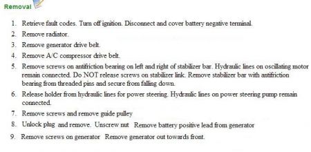

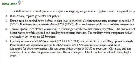

How do you replace an althernator on a 2001 BMW X5 4.4?

https://images.2carpros.com/forum/automotive_pictures/261618_Noname_754.jpg
https://images.2carpros.com/forum/automotive_pictures/261618_Noname2_200.jpg
