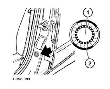

There is a technical service bullitin that was put out by BMW that involves coding the SZM Control unit to improve heating for the seats. The campaiogn number is: SI B 61 04 04 IF there is a 425 on the sticker below than it hasn't been performed, If I understand it clearly.

Thank you for the speedy reply and suggestion, however, I checked with the dealer today and they did check the campaign number you mentioned. Any other suggestions?
I just can't figure out why the seats are warming significantly cooler than before. The service techs mentioned that they also compared our current seat warmers to those in another 2004 X3 that they had on their lot and that they were comparable to the temperature of my seats (currently).
