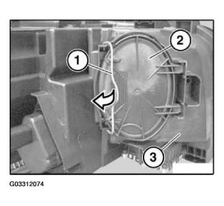

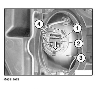

Trying to change small headlight bulb. The one that stays on all the time. Manualsays "apply screwdriver and pop lamp cover off" in engine compartment but no sure what tp pry?
Jan 18, 2009 at 3:14 PM
RACEFAN966
  • 5,029 POSTS
Ok I have included pics of what to do. You will see the bail that hold the cover on over the light that is what you slightly pry on to unlock it and then the access door to the light can be opened to get the the light itself. I hope this helps if you need more instruction just ask.
