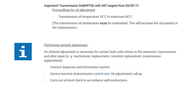

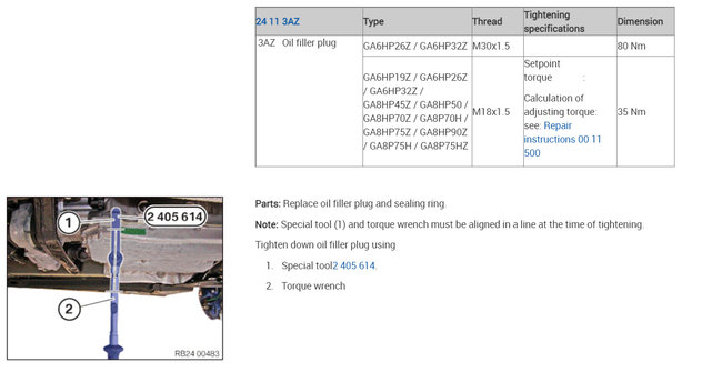

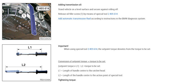

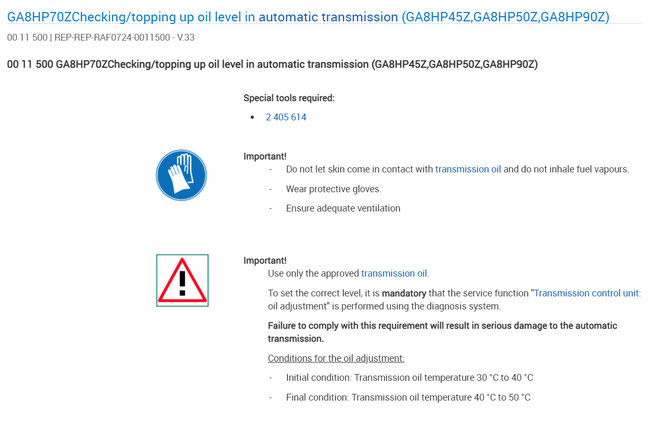

I low pressure code can be caused by a clogged transmission filter which is where I would start. Drop the pan to do the service. This generic guide can help us with specific instructions below for your car. Clear the codes once complete.
