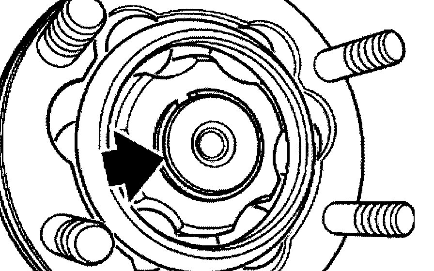

Hello, My car listed above (323i) has been sitting for over a year. It was running smooth before I put it down. Now when I went to drive it the transmission is making noise, coolant leaked causing the engine to overheat, brakes don't feel right. I am thinking every fluid needs a change. Could this be the issue?

I forgot to say that the rear axle was making noise clunking. I think that's what the transmission noise was. When shifting it was like a tiny gunshot noise. I'm thinking the differential fluid needs changing.

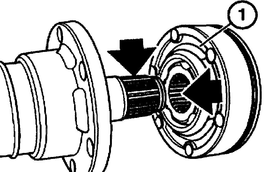

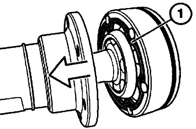

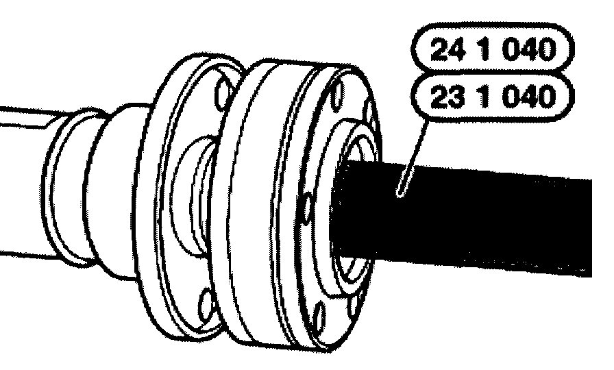

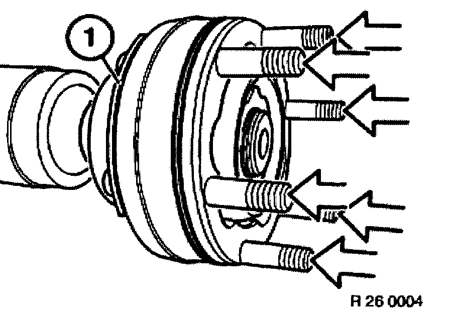

If it hasn't been done, it won't hurt. However, what you described sounds more like a universal joint. On this vehicle, there is what is called a propeller shaft. The drive shaft attaches to it via a constant velocity joint (CV joint). That may be bad and you should check for play in it. Also, I will provide the directions for replacing the differential fluid. That way you can do it yourself and save money.
First, take a look through this link. It discusses universal joints and how to check them and how they work. Yours will be a different design, but the same principals apply
https://www.2carpros.com/articles/how-u-joints-work
If you find the joint is bad, here are the directions for replacement. The attached pictures correlate with these directions. Also, the next section will relate to servicing the rear differential.

CV joint replacement
PROCEDURES
Replacing Constant Velocity Joint For Propeller Shaft
Remove propeller shaft.
pic 1
Lift out retainer.

Install shims (1).
pic 3

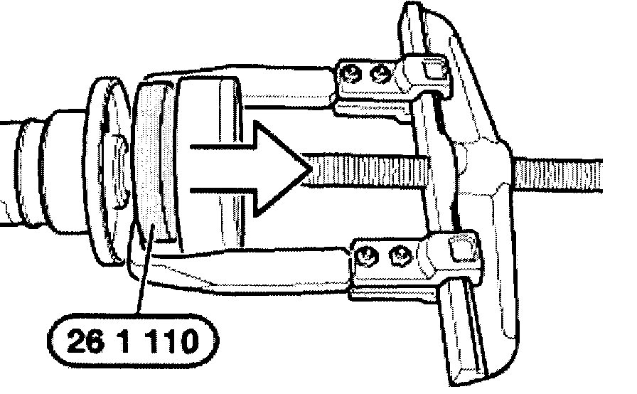

Detach constant velocity joint with special tool 26 1 070 or 261 110.
pic 5
Installation:

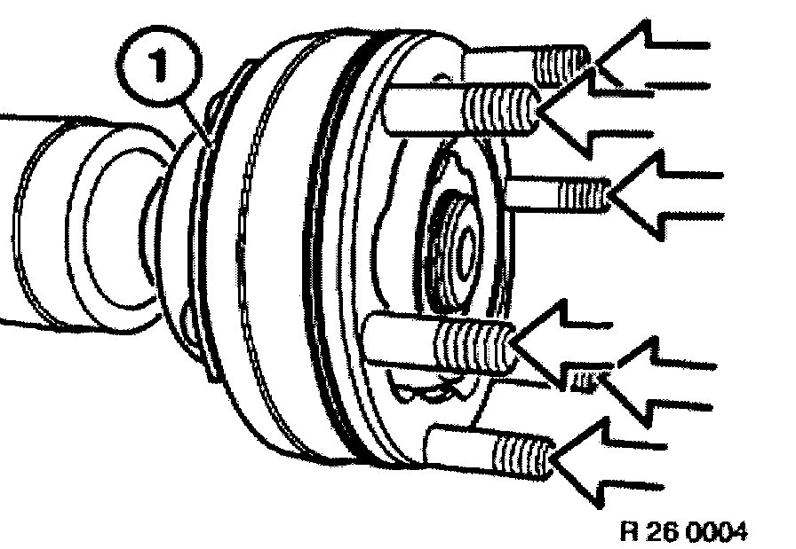

Drive on constant velocity joint with special tool 23 1 040 or 24 1 040 as far as it will go.
pic 6
Installation:
Shoulder (1) for sealing washer must point to gaiter.
Toothing must be free from grease.
Thread locking: apply Loctite 648.
Caution: Do not apply Loctite to the ball races. Clean toothing and apply a light coating of oil.

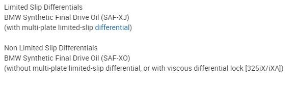

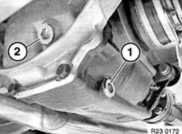

CHANGING DIFFERENTIAL OIL
Changing Differential Oil
Note: Only change oil when differential is at normal operating temperature. Use only recommended differential oils, refer to BMW Operating Fluids MG33.
Catch and dispose of escaping differential oil.
Observe country-specific waste-disposal regulations.
Pic 7
Note: Pay attention to all vehicle variants.
Release drain plug (1).
Unfasten filler screw (2).
Tightening Torque, refer to Technical Data 33 11 3AZ.
Allow differential oil to escape.
Screw in drain plug (1) and tighten down.
Add differential oil until overflowing.
Allow differential oil to drain off.
Screw in filler plug (2) and tighten down.
pic 8

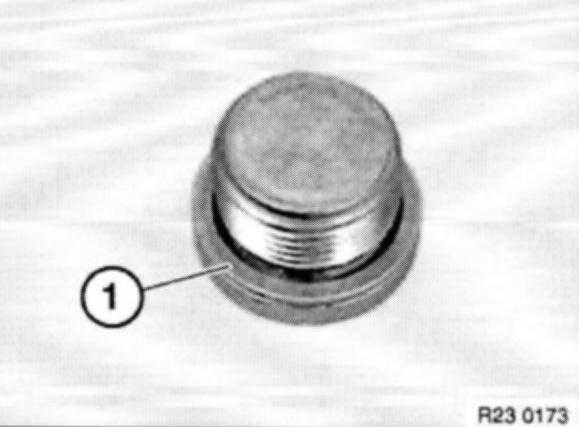

Installation:
Replace sealing ring (1).
Pic 9 shows types required.

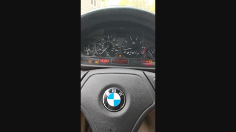

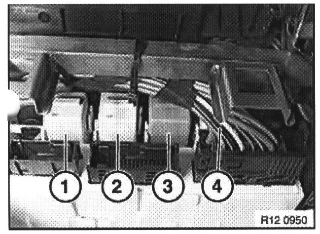

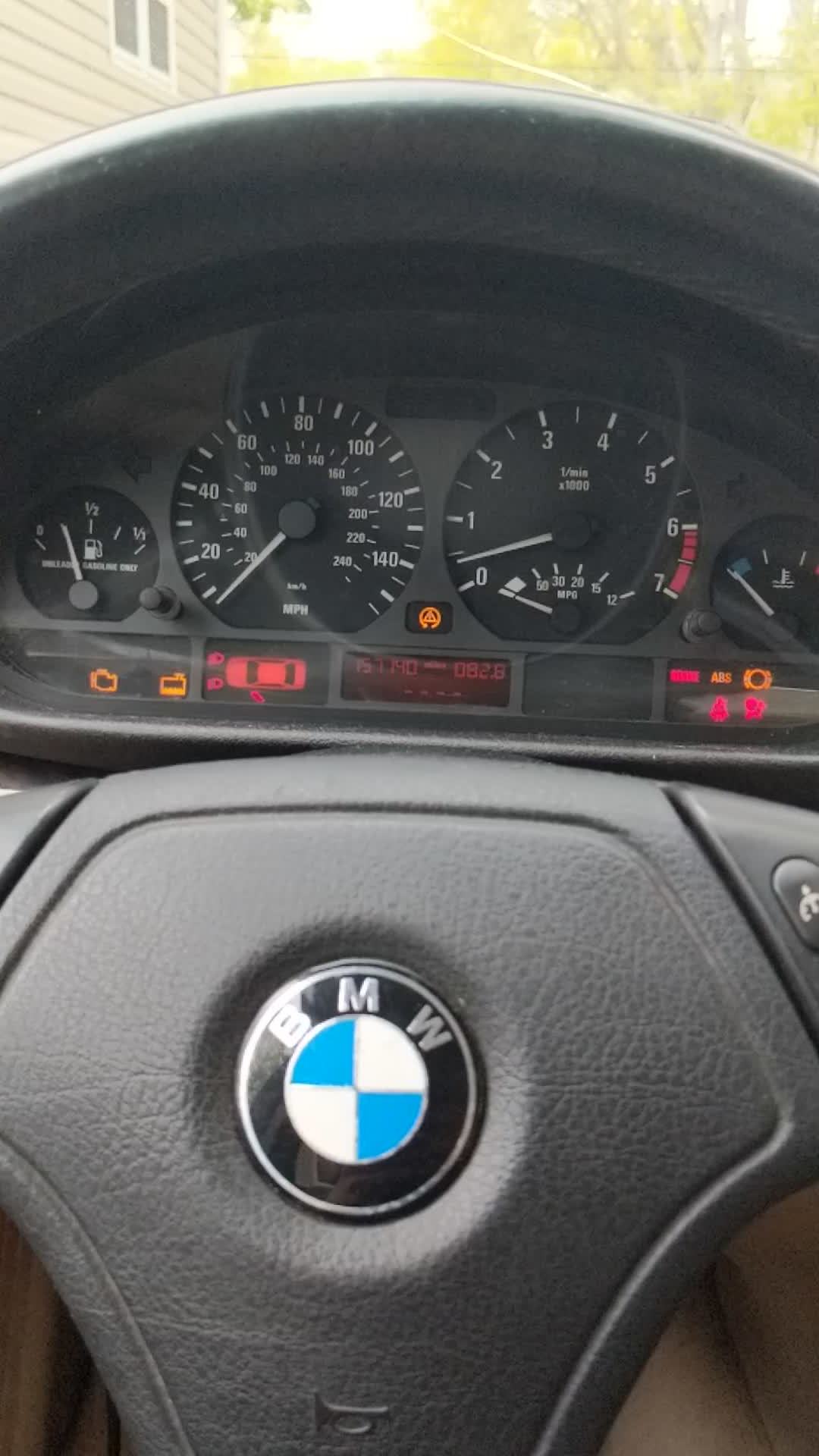

Hello, my scanner picked up dtc codes which are p1250 BMW, p1519, p0170, p0173, p1189, p1188. My guess is that these codes came up because the gas went bad or oil since it was sitting and not changed. I will refill the gas and use marvel mystery oil. I have images and pictures for it. Also I couldn't check the differential fluid and locate the coolant leak because the BMW would shut off.

I had a look at BMW forums and found many BMW's "e46" as mine with the same set of codes. It is either MAF or the fuel pressure regulator I believe.

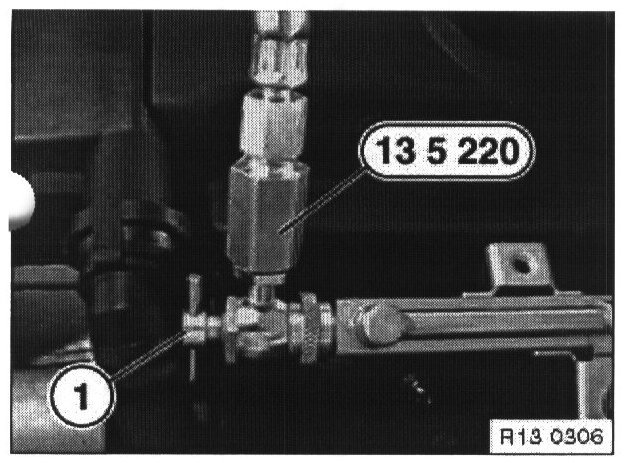

Lets start with fuel pressure / regulator. Here is a link that shows in general how to test pressure and a regulator. Take a look through it.
Here are the directions specific to your vehicle. The attached pics correlate with the directions.

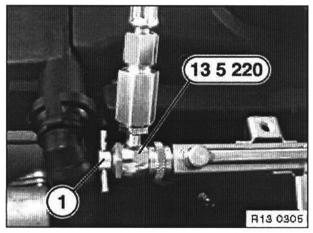

Checking fuel pump delivery pressure (M52, M52TU)
Turn off ignition.
pic 1
CAUTION!
The fuel in the fuel lines is under pressure (approx. 3 bar)!
Catch and dispose of escaping fuel.
pic 2

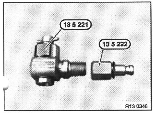

Prepare special tool kit 13 5 220 (consisting of 13 5 221 and 13 5 222).
Connect special tool kit 13 5 220 to pressure sensor of DIS Tester.
pic 3

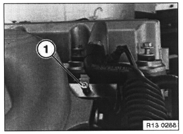

Remove dust cap (1) from measuring valve on fuel rail.
pic 4
Unscrew check valve (1) on special tool so that valve remains closed in fuel rail.
Attach special tool kit 13 5 220 to fuel rail and tighten down firmly so that sealing ring in special tool is sealed.
pic 5
Start engine.
Screw in check valve (1) on special tool until a pressure reading is displayed at DIS Tester.
CAUTION!
Do not under any circumstances screw in the check valve up to the mechanical stop. This could damage the measuring valve in the fuel rail.

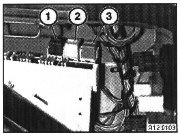

Checking fuel pump:

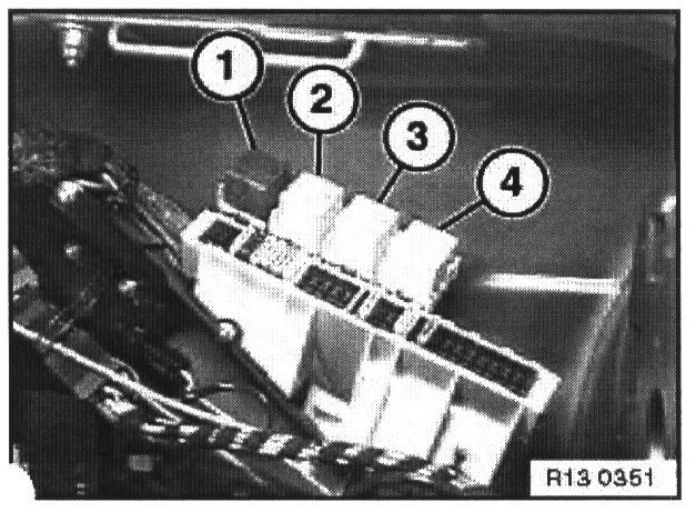

E39:
Detach fuel pump relay (2).
pic 8
E46:
Remove fuel pump relay,
pic 9
E38:

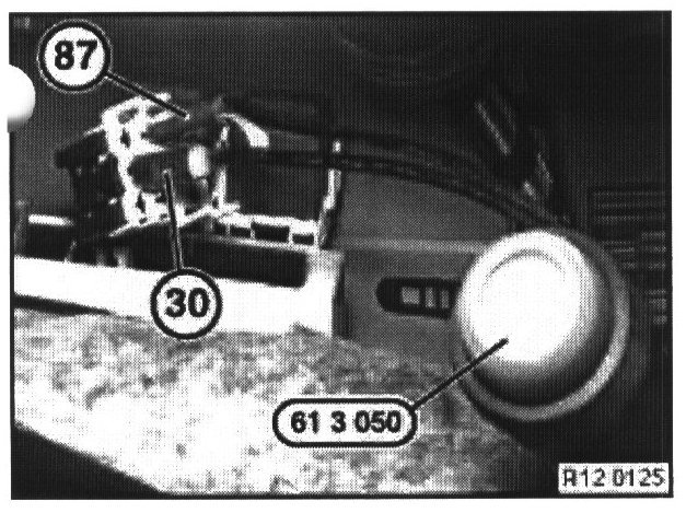

pic 10
Connect up special tool 61 3 050 to terminal 87b and terminal 30.
Operate button for approx. 10 sec and read off delivery pressure at DIS Tester.
