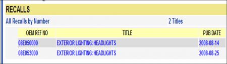

Hello - Hey - the car may some recalls on it. The dealer may fix these for free. Is there a dealer there that can check these and fix for free if they apply? Or this may be the same thing......once you have her VIN check here and then see what they can do for you if the car is there.
https://images.2carpros.com/forum/automotive_pictures/248015_Picture2_42.jpg
