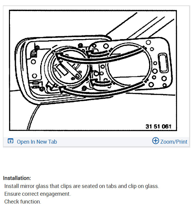

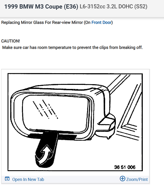

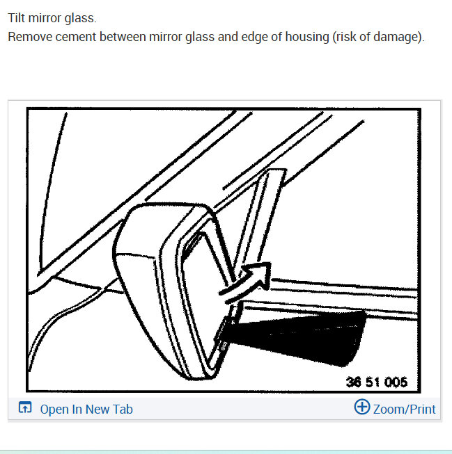

Came out of store and mirror hanging on side of door no apparent damage looks like I can just press it back on not sure if I will damage anything any suggestions, or do I just buy a new one?

The side view mirrors are secured by a locking plate that is on the mirror. Is it still there? If not the mirror may require replacement.

Here is how to reattach the mirror for the drivers side door. Check out the images (below). Let us know if you need anything else.
