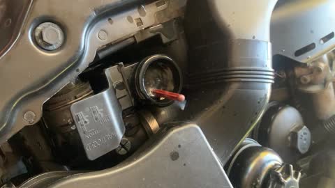

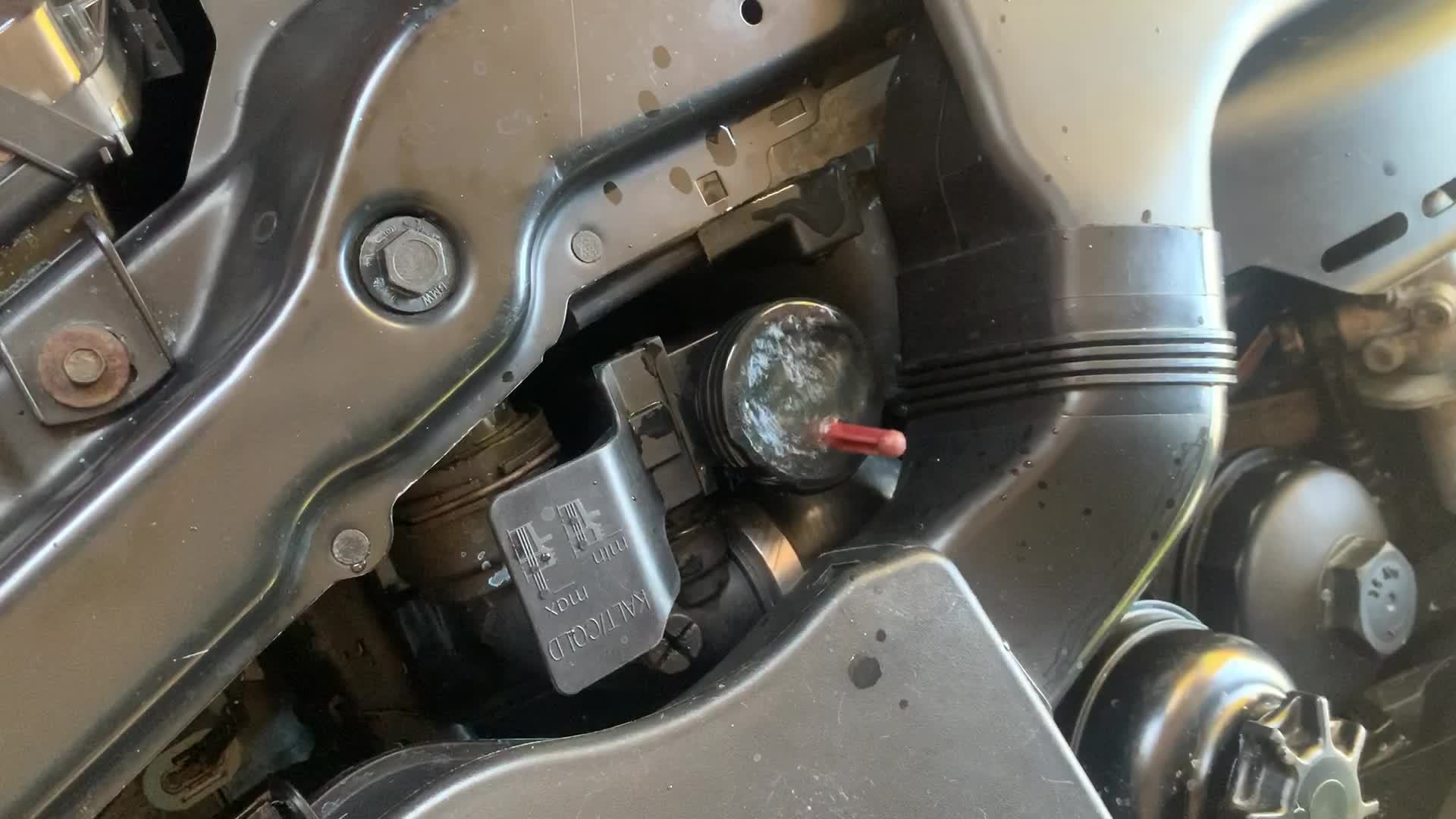

So I changed my lower radiator hose because it was leaking coolant and after I went for a ride, I saw that my temperature needle went high enough to the red part. After my car cooled down I bleed the system (with the bleed screw off of the upper radiator hose) and my car kept overheating so I tried to bleed it again but instead of using the bleeder screw I left my radiator cap off and started the car, at first I saw some bubbles coming from the tank but after a while it started to overflow and it was kind of boiling. I've even flush my coolant system and this keeps happening. can you guys help me out with this?
BMW E46
May 26, 2021 at 10:55 AM
PAISITAG
  • 5 POSTS
this is a video I recorded .

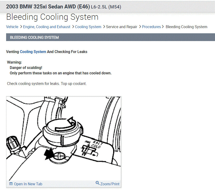

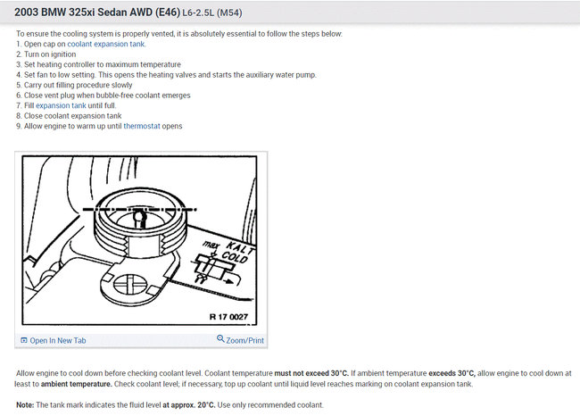

When you bled the system, did you have the heater on? If you don't, it won't actuate the auxiliary water pump. Do me a favor. Take a look at the directions below. These are the specific directions for bleeding the cooling system on this vehicle. Let me know if this is what was done. If it wasn't, try it and let me know if it helps.
May 26, 2021 at 1:50 PM

Yesterday the auxiliary fan did not turn on when the engine was getting hot but today it did. so I went for a ride and my temperature needle was fluctuating between the red mark and the middle, so I turned off engine and lift the hood and I saw my coolant was overflowing from the expansion tank cap (a lil bit) and it was very hot this time, also steam was coming from the cap. After I waited for like 30 minutes for the car to cool down a little bit. so when I turned my ignition and I check my coolant temperature from the dashboard it was almost cold,(I think it marked 44) knowing the car had been overheated.I turned the car again and saw that the temperature came back as it was. Any ideas about this?

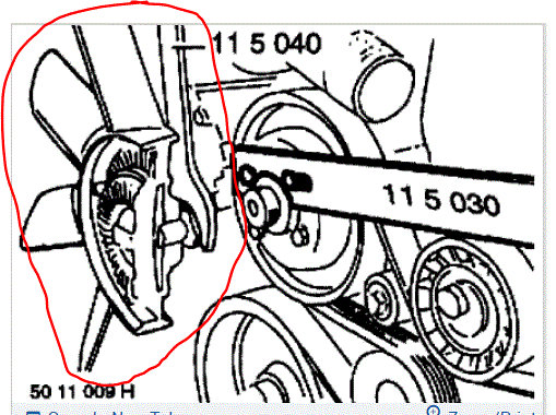

Do me a favor. Check to see if there is a fan clutch on the vehicle. It won't be electric but belt-driven. My manual is showing that it should have one. See the attached pic below.
Take a look through these two links:
https://www.2carpros.com/articles/how-a-clutch-fan-works
https://www.2carpros.com/articles/fan-clutch-symptoms
