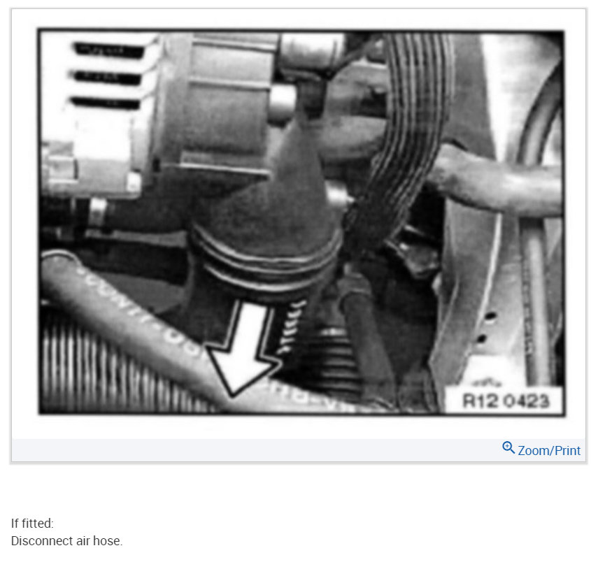

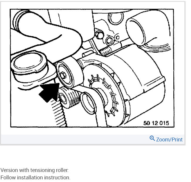

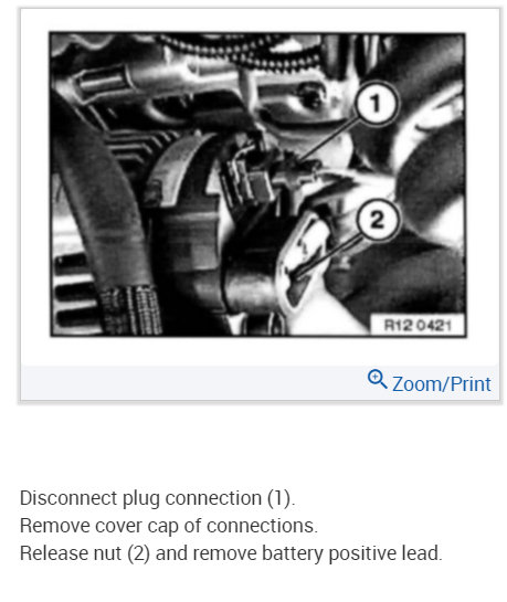

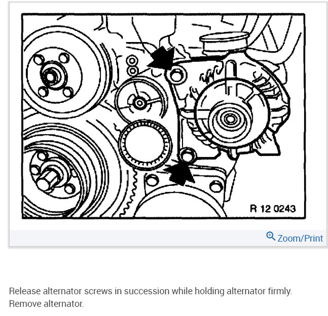

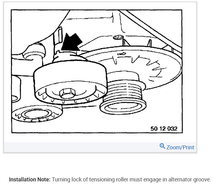

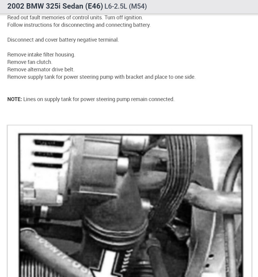

Yep, alternator can go bad draining the battery. Here is a guide to show you what you are in for when changing the alternator out and diagrams to help you see how on your car below:
https://www.2carpros.com/articles/how-to-replace-an-alternator
