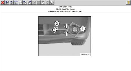

how do i replace fog light bulbs on 2006 bmw 750i?
if you have diagram also would be much appreciated.
Jan 1, 2010 at 8:06 AM
  • 75,992 POSTS

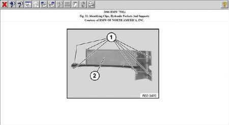

Hi rolandrrf, Welcome to 2carpros and TY for the donation and selecting us as your auto repair site Feel free to ask questions at anytime and Merry Christmas and a Happy New Year 2010 Removing And Installing (Replacing) Left Or Right Front Fog Lamp Unlock inner catches (1) and pull off trim grill (2) in direction of arrow. Fig. 30: Identifying Screw see bmw1 pic
https://images.2carpros.com/forum/automotive_pictures/12900_bmw1_1.jpg
Courtesy of BMW OF NORTH AMERICA, INC. Installation: Retaining hooks (1) of trim grill (2) must not be damaged. Fig. 31: Identifying Clips, Hydraulic Pockets And Supports Courtesy of BMW OF NORTH AMERICA, INC. Release screw (1).See bmw2

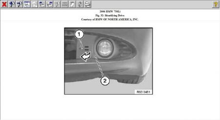

Feed out front fog light (2) in direction of arrow. Fig. 32: Identifying Drive-See bmw3
https://images.2carpros.com/forum/automotive_pictures/12900_bmw3_1.jpg
Courtesy of BMW OF NORTH AMERICA, INC. Secure front fog light (2) against falling out. Disconnect plug connection (1) and remove front fog light (2). Fig. 33: Identifying Front Fog Light And Plug Connection-see bmw4
