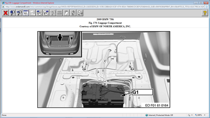

Battery discharges after every stop. Gets driven at highway speeds over 30 mins. twice daily. Tried charging and still won't stay charged. Want to change battery to new one, but can't find it.
Dec 10, 2011 at 12:40 PM
RIVERMIKERAT
  • 6,110 POSTS
The battery is located in the trunk ij th center well here is a guide to help walk you through the steps and the battery location in the diagrams below.

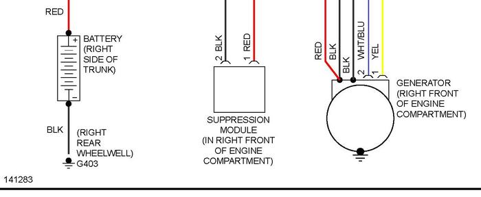

ALBERTWATSON
computer screen tells me battery is discharging when car is stopped plus to charge the battery.the battery is showing 920ccamps when i check it,i am stummped.
Feb 7, 2019 at 10:39 AM (Merged)
CARADIODOC
  • 34,381 POSTS
How are you getting 920 cca? That requires a professional load tester, but it's a test for the capacity of the battery. A discharging battery is due to a failed charging system. To verify that you need to measure the battery voltage while the engine is running. It must be between 13.75 to 14.75 volts. If it is low or is staying near 12.6 volts, the generator is not recharging the battery while driving.
