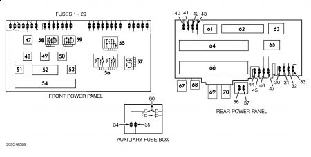

my highbeam headlights will not come on. the dash indicator lights up but the high beams do not come on. is there a relay or some simple fix that anyone knows of?
thanks.

Have you checked the lights to make sure they are good? the only other problem could be your dimmer switch in the steering Council is no good, check for power at the headlight connection, try activating your dimmer switch several times to see if that is the problem. Sometimes when you're playing with your dimmer switch. The lights may come on for a second.

I have done most everything that you have suggested, I have even changed the highbeam lights to see if that would work.
Is there a relay that controls the highbeams? if so where is it locatated?
thanks again for the help

I am having a hard time sending you a photo of the fuse box. If you do not get it, send me your e-mail address. 1 - 7.5 Amp Instrument Panel, Windshield Wiper 2 - 7.5 Amp Low & High Beam Relay 3 - 7.5 Amp Flashlight 4 - 7.5 Amp Left Turn Position Light 5 - 10 Amp Right Turn Position Light, Instrument Light 6 - 7.5 Amp Hazard Warning Flashers 7 - 15 Amp Foglight 8 - 7.5 Amp Side Marker, License Plate Light 9 - 15 Amp Horn, A/C Compressor Clutch 10 - 7.5 Amp Left Low Beam 11 - 7.5 Amp Right Low Beam 12 - 15 Amp Power Mirrors, Back-Up Lights 13 - 7.5 Amp Left High Beam 14 - 7.5 Amp Right High Beam 15 - 7.5 Amp Brakelights 16 - 30 Amp Heated Seats 17 - Blank 18 - 15 Amp Theft Deterrent System 19 - 30 Amp Fan Blower Motor 20 - 7.5 Amp Check Control Panel 21 - 15 Amp Interior, Luggage Compartment, Glove Box Light 22 - 30 Amp Headlight Wash System 23 - 7.5 Amp Main & Auxiliary Fuel Pumps 24 - Blank 25 - 30 Amp Auxiliary Fan 26 - 30 Amp Cigarette Lighter 27 - Blank 28 - Blank 29 - 7.5 Amp Auxiliary Fan, Rear Window Defogger, ABS System, A/C Relay 30 - 7.5 Amp Central Locking System (Driver's Door# 31 - 7.5 Amp Central Locking System #Except Driver's Door) 32 - Blank 33 - 7.5 Amp Electronic Heating Control 34 - Blank 35 - Blank 36 - Blank 37 - Blank 38 - Blank 39 - Blank 40 - Blank 41 - 30 Amp Radio/CD Player 42 - 30 Amp Driver's Power Seat 43 - 30 Amp Passenger's Power Seat 44 - 30 Amp Windshield Wiper/Washer System 45 - 30 Amp Level Control System 46 - 30 Amp Rear Window Heater 47 - Starter Relay 48 - Washer Pump 49 - ABS Relay 50 - Parking Light Relay 51 - Hazard Flasher Relay 52 - Check-Control Module 53 - Crash Control Module 54 - Light Control Module 55 - Blower Relay 56 - Front Defogger/Water Pump 57 - Unloader Relay (K9) 58 - Horn Relay 59 - Unloader Relay (K3) 60 - Phone Alert Buzzer Relay 61 - Blank 62 - Blank 63 - Rear Headrest Control Module 64 - Control Module 65 - Blank 66 - Relay Module 67 - Wiper Pressure Control Relay 68 - Blank 69 - Right Rear Seat Heating/Position Relay 70 - Left Rear Seat Heating/Position Relay
https://images.2carpros.com/forum/automotive_pictures/307270_1988_750IL_1.jpg
