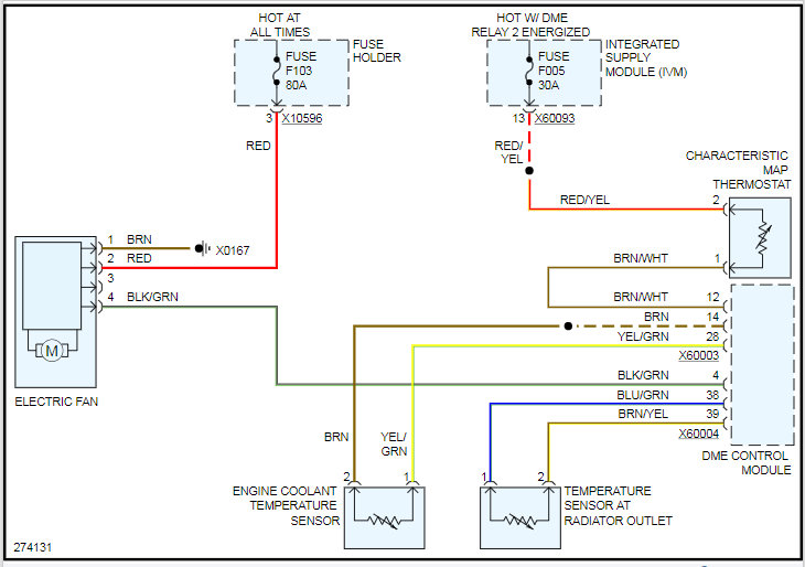

This is regarding the car listed above 745LI. I have recently changed coolant thermostat, upper and lower coolant sensor and radiator fan. I keep on getting Engine overheated at 107C. The Water pump is working fine as I can see a steady stream of coolant in coolant reservoir. The coolant is between Min and Max range (no coolant leak).
Upper radiator hose is hot and lower radiator hose is warm to touch.
I am able to drive for 30 minutes continuously and the message keeps on popping and disappears and this cycle continues.
Also the radiator fan does not come on when the overheating message pops up. Only when I start the A/C, the fan starts.
Any help is demystifying this issue is much appreciated.

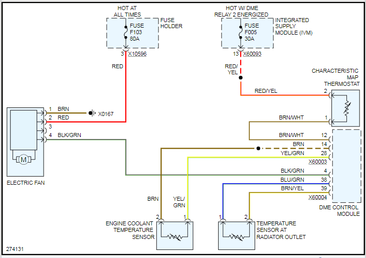

You only have one fan correct? From what I remember this was one large fan and not two smaller fans? If that is the case, we need to figure out why the fan is not coming on. If this message is coming on, that fan should be on high. So if we solve that then I suspect this message will stop coming on.
Do you have a scan tool that can monitor the DME module? We need to see what the module is seeing as temp on these sensors. Since they are new, and it is no change we can assume they are not the issue. So if the fan works when the AC is on then the fan is not the issue. If you replaced the thermostat as well, the only thing really left is the module but I would like to confirm this before we replace it.
Let me know and we can go from there. Thanks

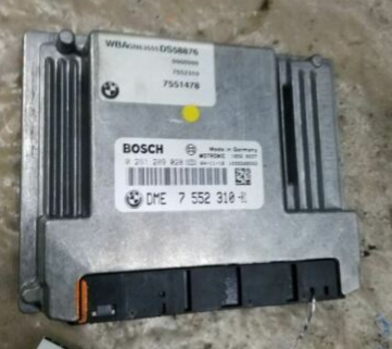

Thanks for your prompt response. I do have Foxwell scanner not sure if it checks coolant temperature sensor readings. I will do some tests today. Also does the DME module is change as 1 piece or there fuses that can be replaced?
Nov 18, 2020 at 6:17 AM

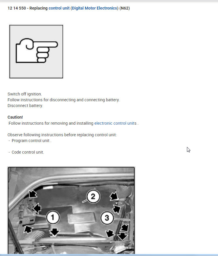

Okay. Yeah that would be good if it does. If you want to get some screen shots of the info it has I can help if you are not sure.

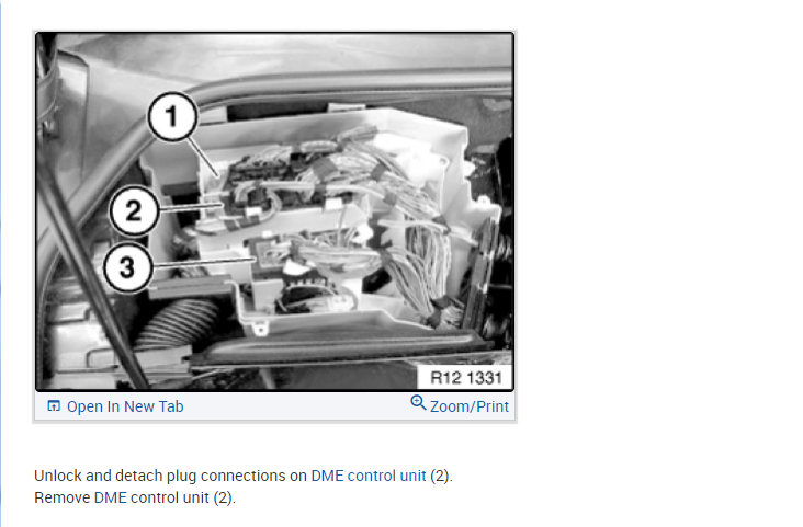

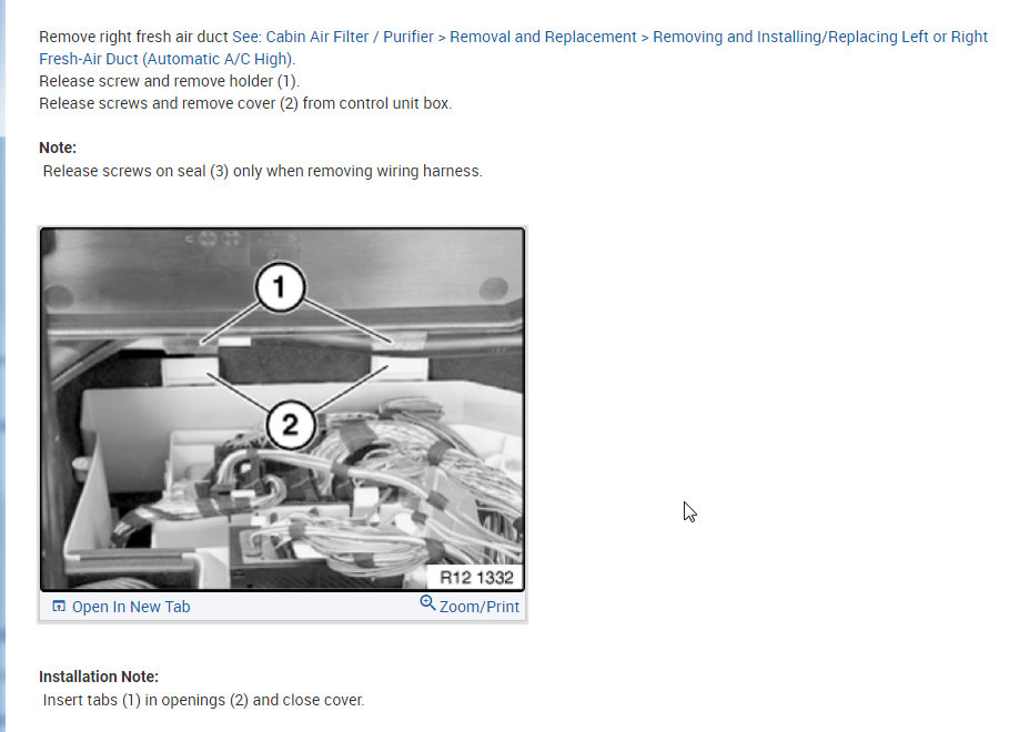

Also, I attached the picture of the DME and it is not something that has replaceable fuses or relays.

I think you have a restriction in the system. 107 C is a little high so I just want to confirm that the fan is coming on at this point? Or when you say it is triggered, that means you are commanding the fan on with the tool you are using?
If you command the fan on and it comes on but it is not coming on when it is reaching that temp then that is a concern as well.
So let's try and eliminate one of the two of these issues, restriction or fan issue. If you can command the fan on, can you drive the vehicle and see if the message pops up while the fan is running? If it does not then we have a fan issue. If it still comes on, then we have a restriction in the cooling system. The fact that it doesn't overheat while sitting still at idle actually points to both issues so we need to try and eliminate one.

Okay. That is the issue we need to deal with first. You have two sensors that could prevent the DME from turning on the fan that is the upper and lower temperature sensors. If you have replaced these and the fan works when the A/C is on, then I would replace the DME. It just does not appear to be commanding it on so when you take its place with the scan tool, it turns on then the DME is not doing it and I would replace it.

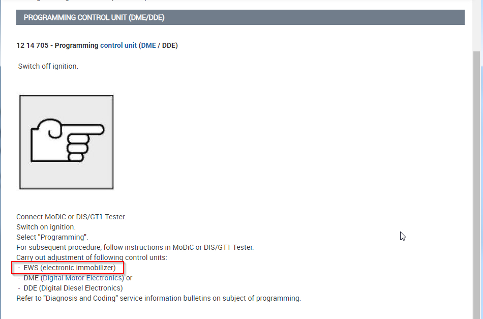

Okay so if I get a exact model used DME, do i still have to program it? If so what are my options?
Nov 24, 2020 at 3:38 AM
The manual does not specify what programming will do other then it needs to be programmed so I can't tell you for sure but it appears you cannot use a unit out of another vehicle. The reason is, part of the programming is for the immobilizer unit. This means you need to program the keys to it so that the security system does not prevent the start of the engine. This may just be a back up of the theft system and not matter but based on this, I would not try and use a used module.

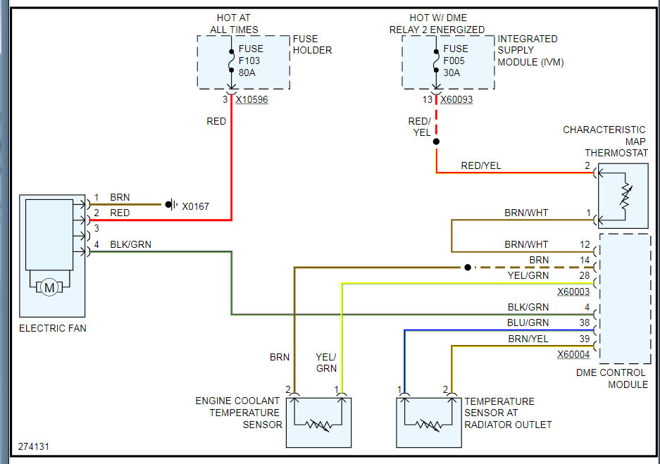

Okay. We need to check the fan operation again. I think that is the issue. When the fan doesn't run this message comes on at 107. This temperature is the max temperature which is why the message is coming on and it will overheat if the temperature doesn't come back down. So this takes us back to the DME not commanding the fan on. So let's confirm the fan is not running again and we need to address that.

I was able to command the FAN to on via a BMW diagnostics OBD2 software called ISTA plus. I was able to trigger the fan to full speed for 30 seconds.
Dec 1, 2020 at 8:44 AM
So you are proving out the circuity from the DME to the fan and that the fan works. Also, you previously replaced the sensors and the only thing left is the DME. So if it were me, I would replace it. Clearly if you got a faulty temperature sensor out of the box that would throw a wrench in this but that is highly unlikely that you would have an issue and get another sensor that causes the exact same issue.

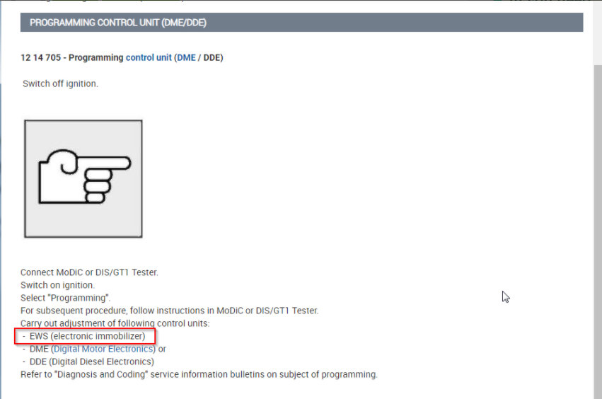

Can I get a used DME from eBay and replace it? Does it have to be reprogrammed?
Dec 2, 2020 at 3:33 AM
The manual does not state specifically what is done when you program the DME. It does need to be programmed but without the detail about what is done during the programming I can't answer that.
As you can see from the attachment the immobilizer system is part of the programming but this is normally just a back up of the information and does not require to be done in order to start the vehicle.
So to answer this question, I think you will need to call a dealer and ask one of the technicians this question. I have not replaced one of these with a used unit so I don't know for sure.
Sorry I can't answer that but I don't want to tell you that it can be used and then be wrong. Nor do I want to be on the safe side and say it can't be used and you spend more money then you need to.

If the DME is bad would there be any additional symptoms I can experience or monitor? As no CEL code is thrown.
Dec 5, 2020 at 2:01 AM
Normally yes, but that is when the entire unit fails or something that effects other circuits like a 5 volt reference circuit. Unfortunately with this issue it is a single circuit on the board within the DME that is most likely open. This means it is a single contact that is used to send voltage to the fan and the DME is not doing it. Clearly the fan can work as you can command it on but the circuit within the DME that is supposed to do this is not. So if there were other things on this same circuit in the DME then it would not work either but unfortunately there is not, it is just the fan. There are no codes because there is no feedback signal from the fan that is telling the DME that it did not actually turn on. The signal that it is not working is the fact that the fan does not work. With no feedback circuit, the DME just turns the fan on and it has no clue if it does it or not. It only knows the temperature is too high so it displays the message on the cluster. It would be nice if it displayed "Overheat due to the fan not coming on and the DME is the issue" but it doesn't so we have to piece it together like this.
