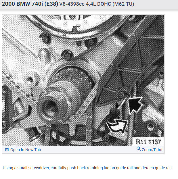

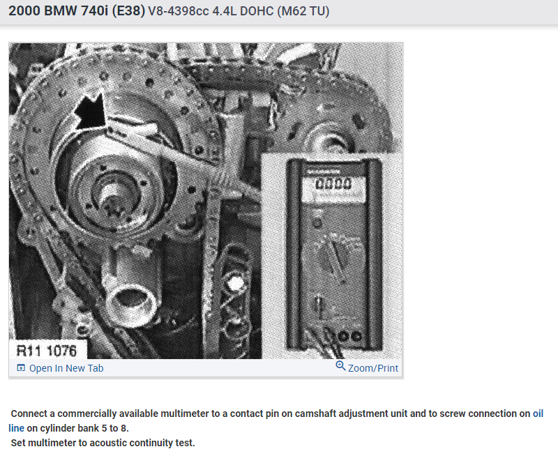

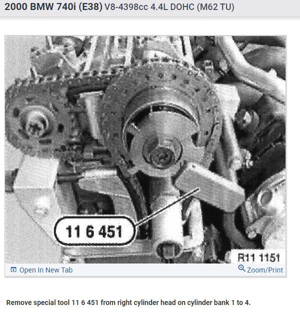

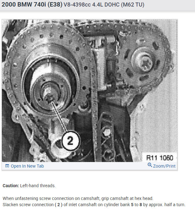

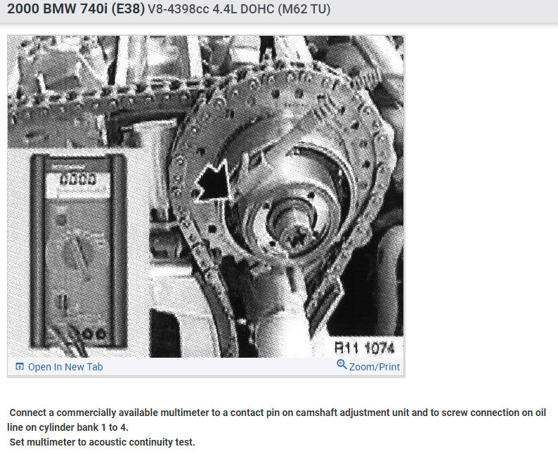

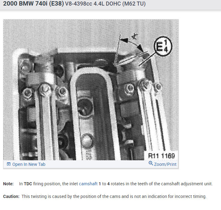

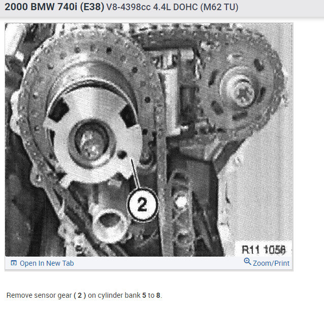

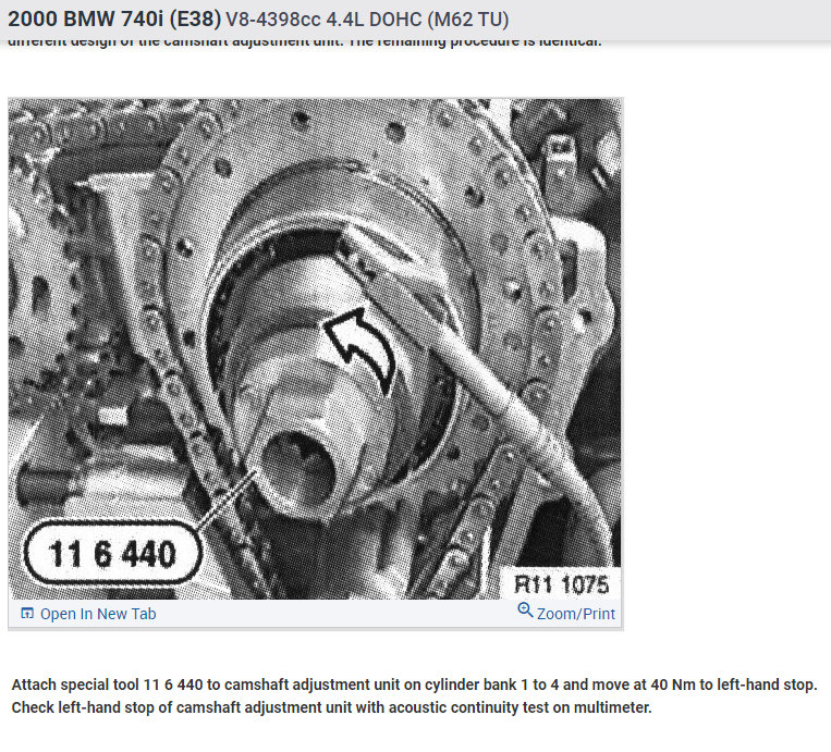

need timing marks. pictures, specs, any help please!!! I need to replace the chain, can you help me?

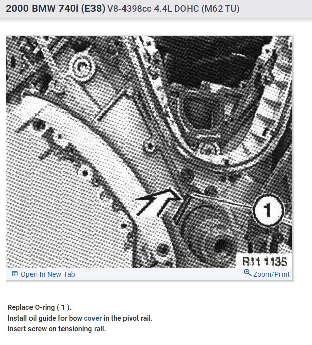

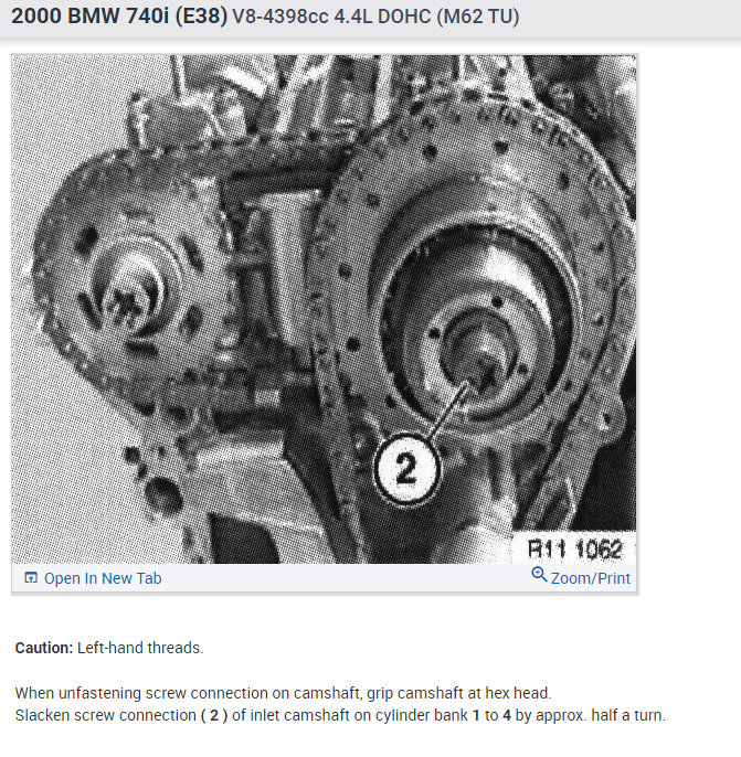

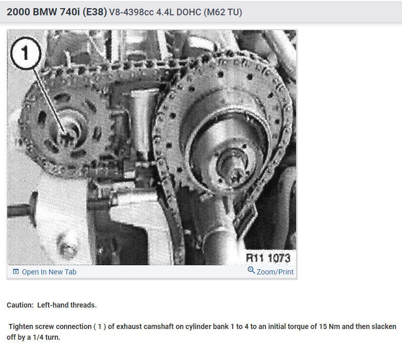

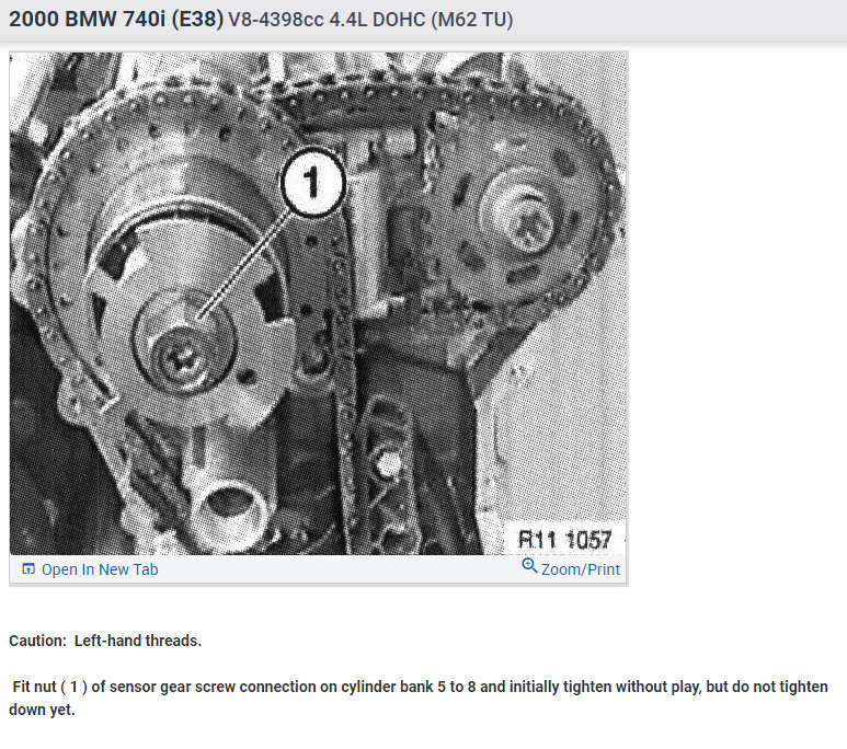

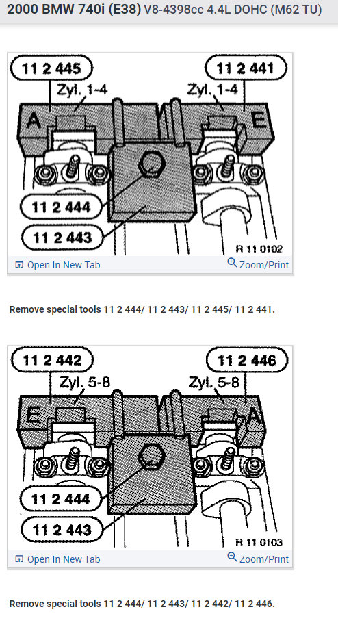

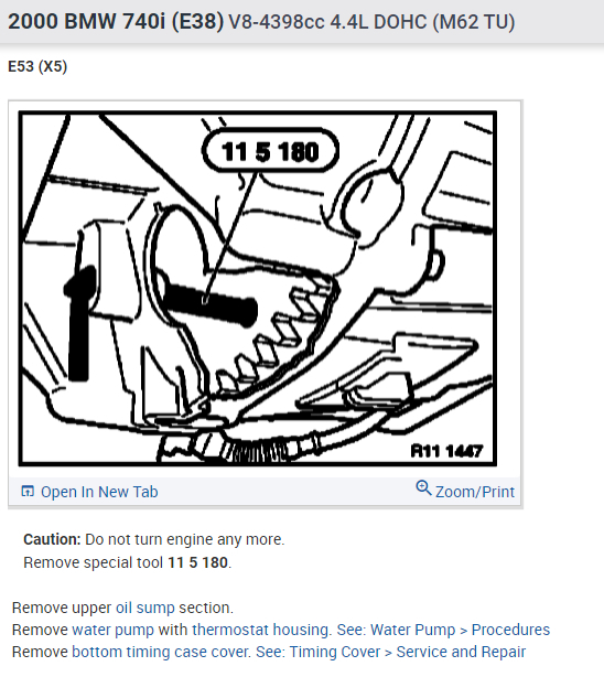

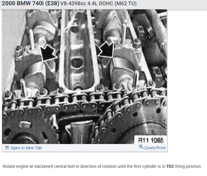

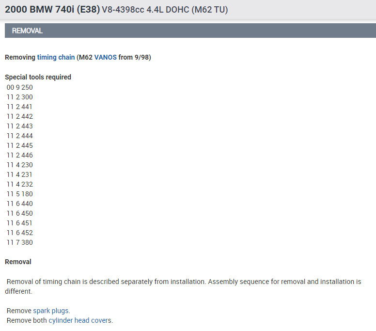

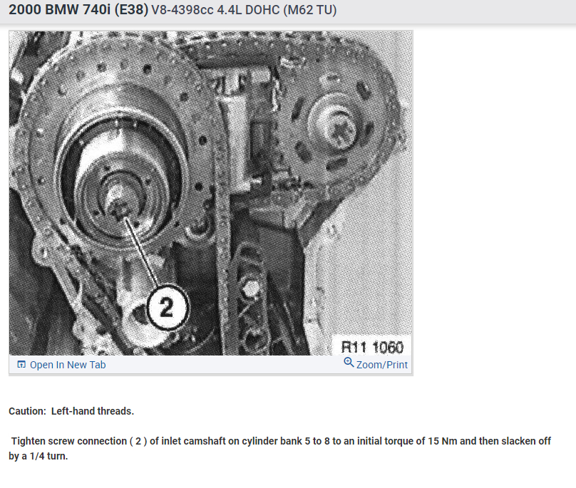

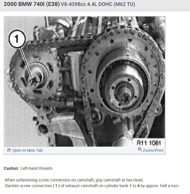

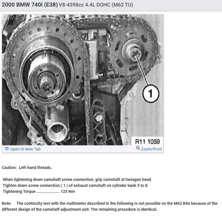

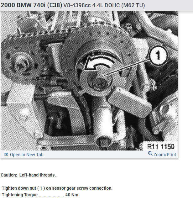

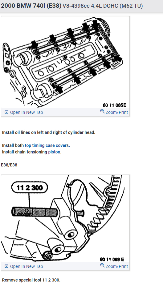

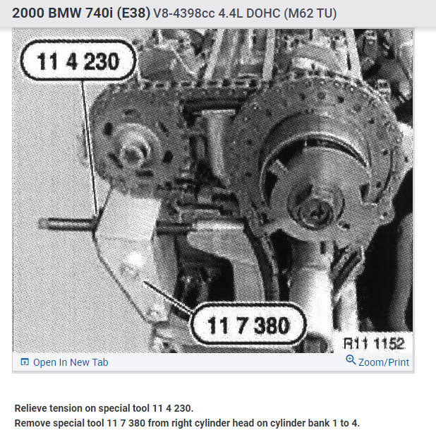

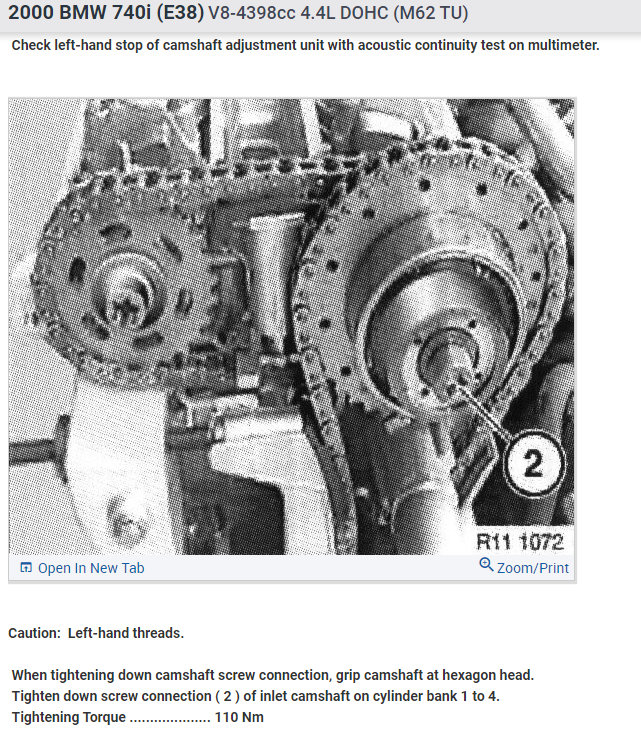

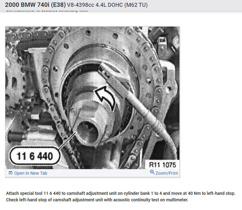

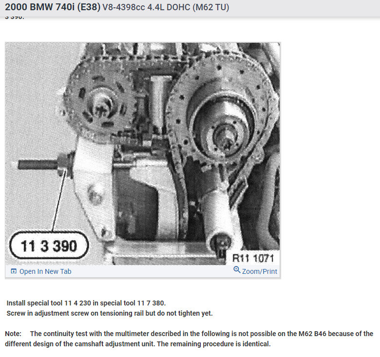

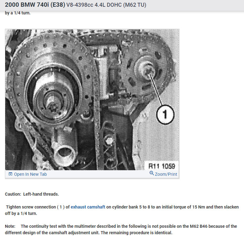

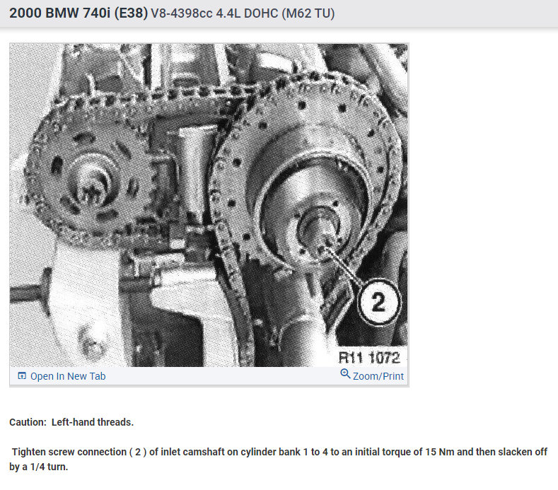

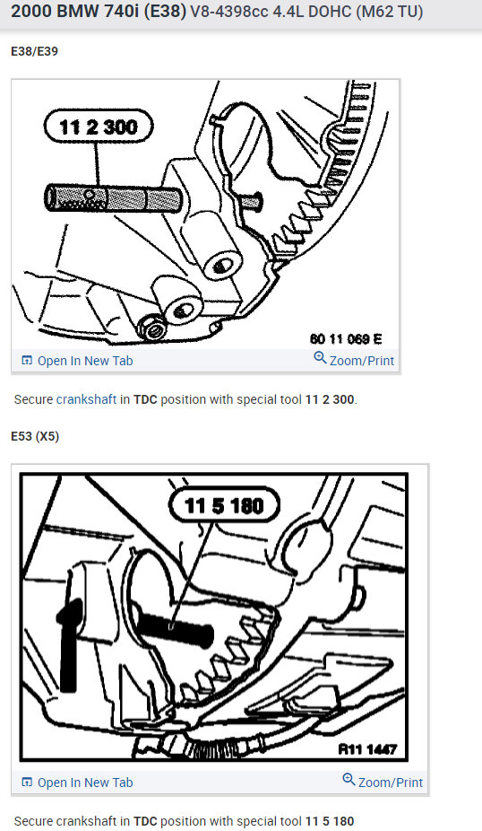

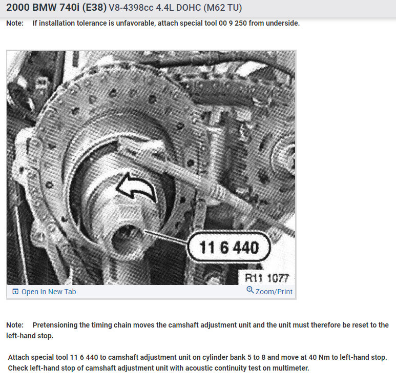

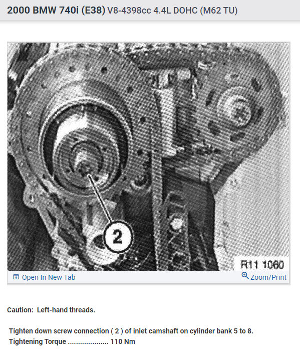

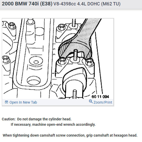

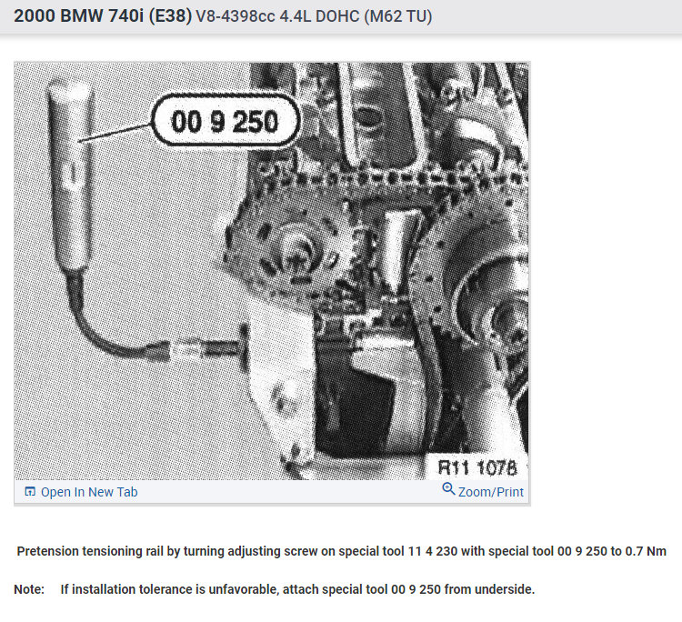

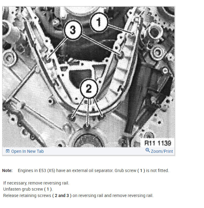

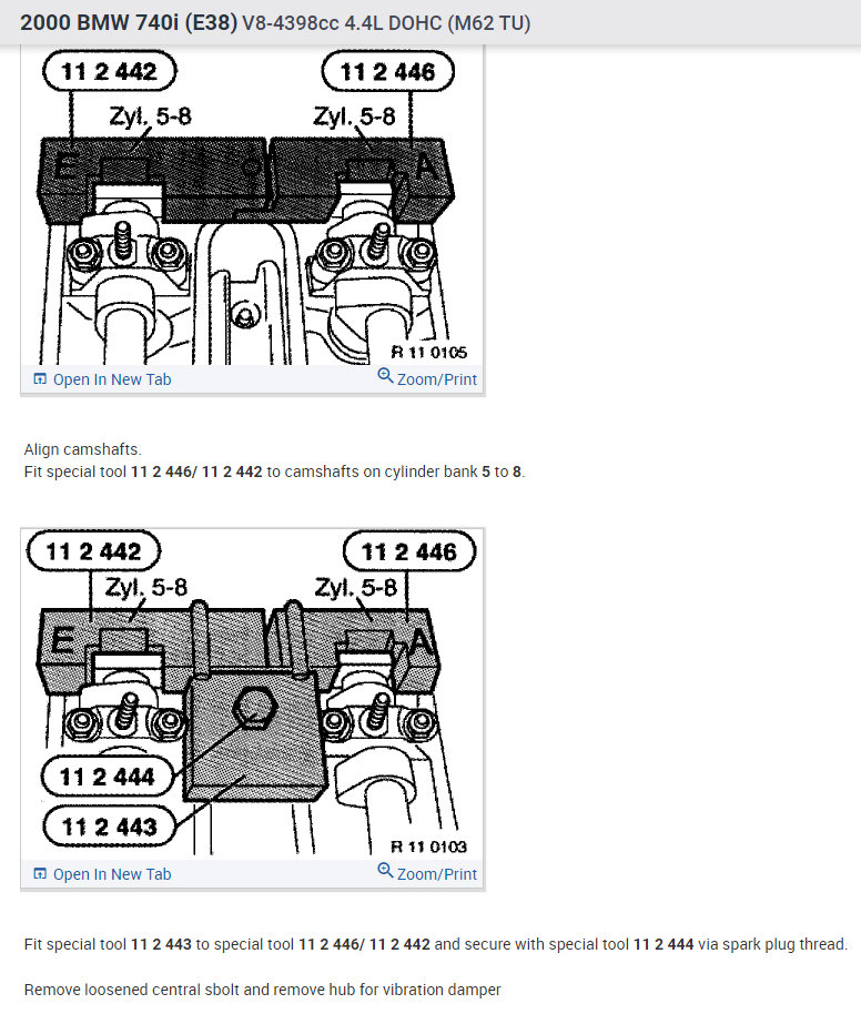

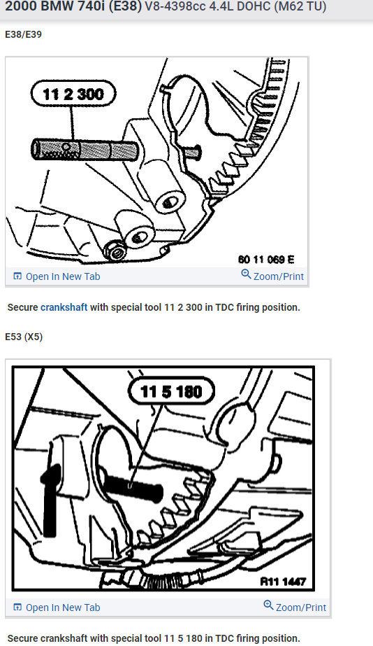

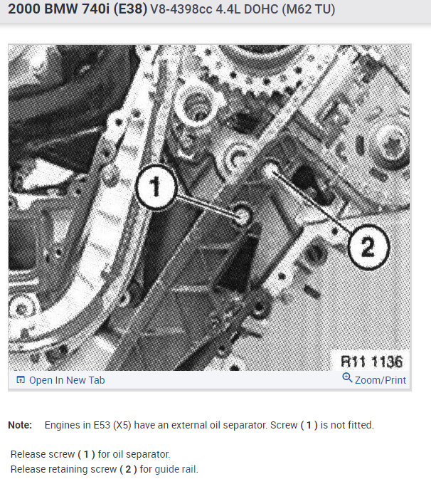

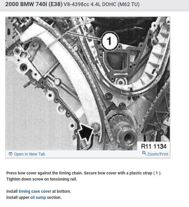

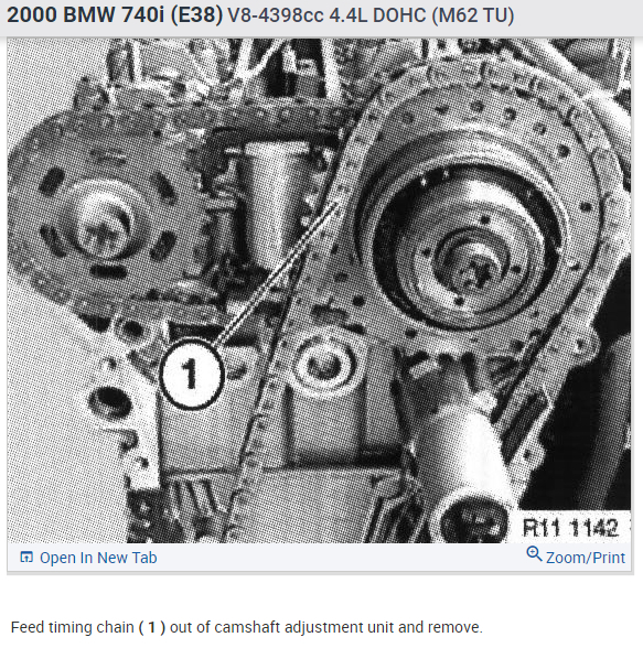

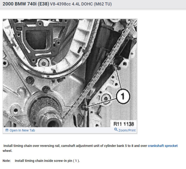

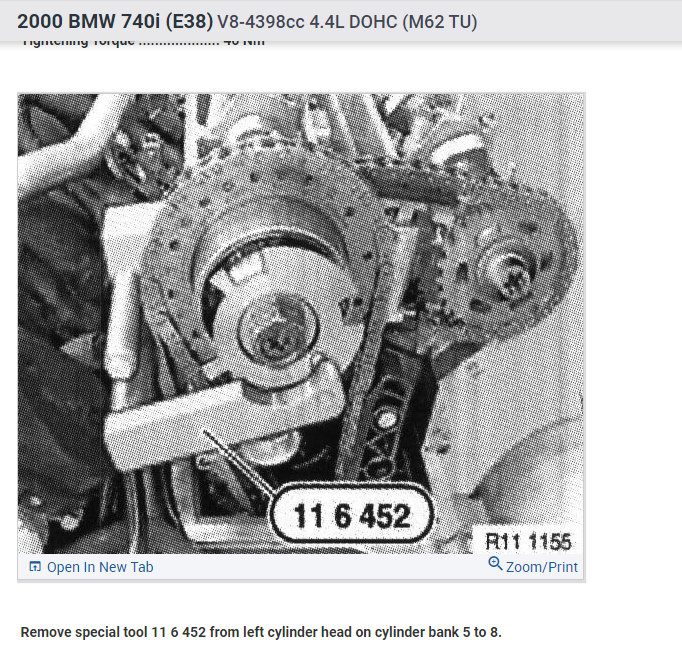

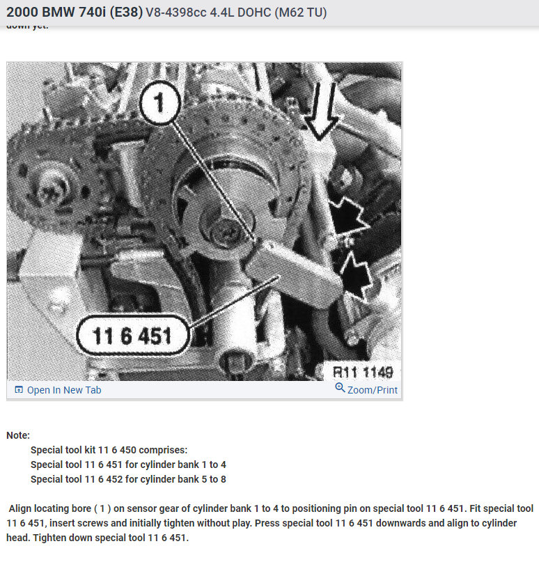

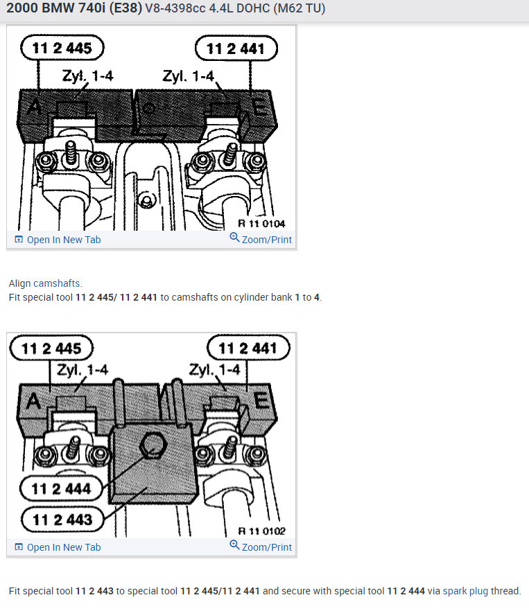

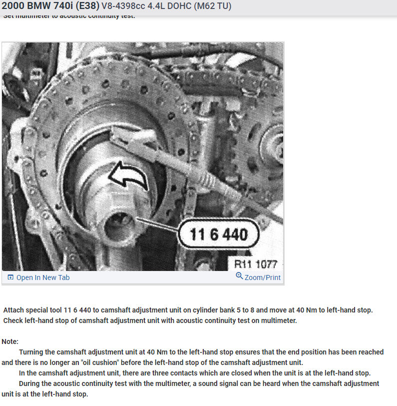

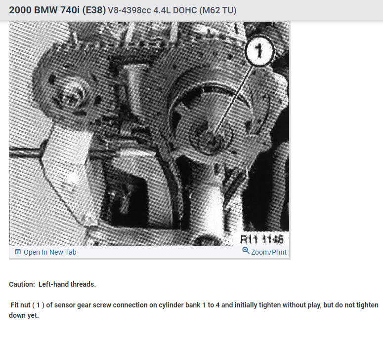

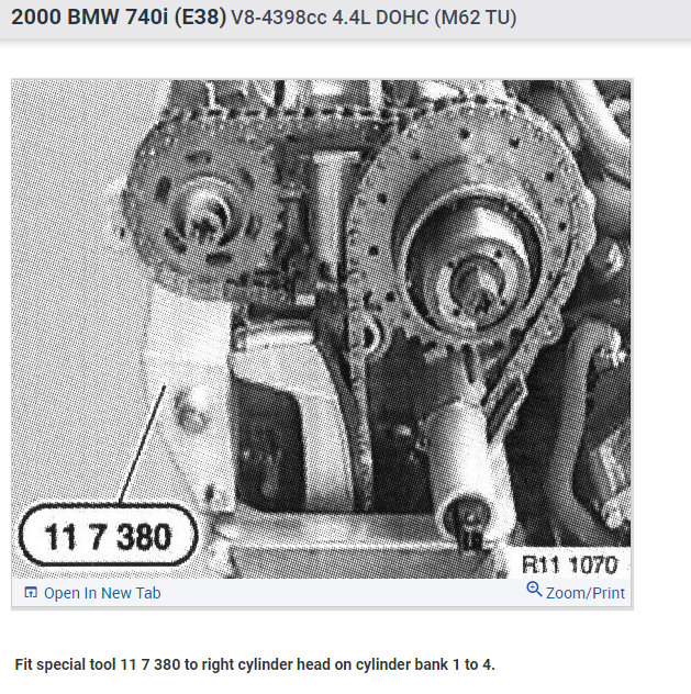

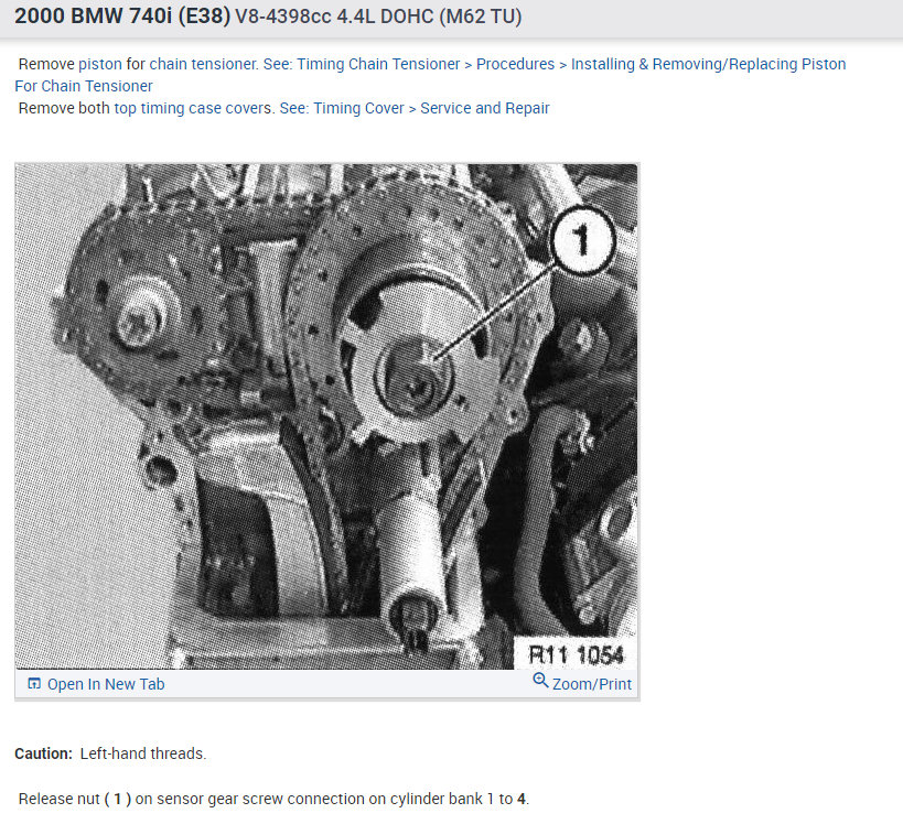

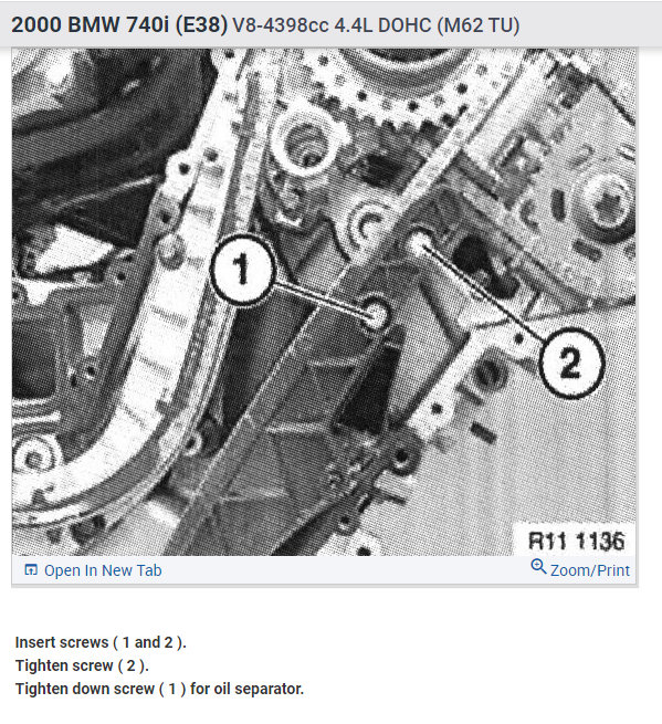

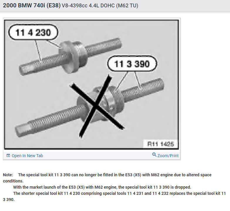

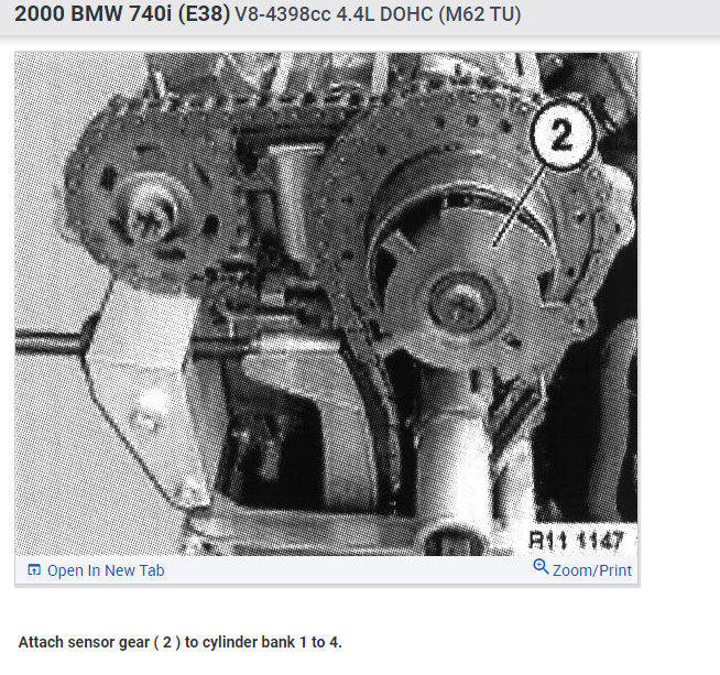

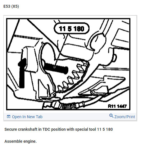

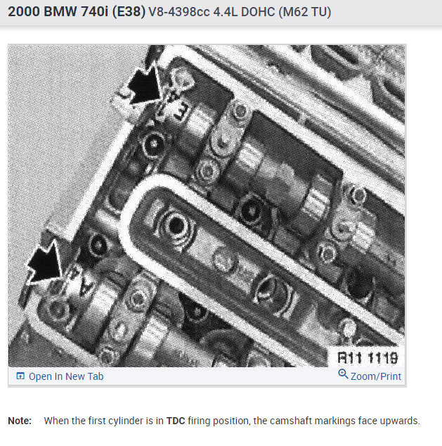

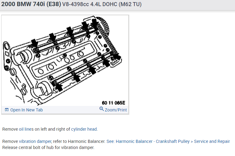

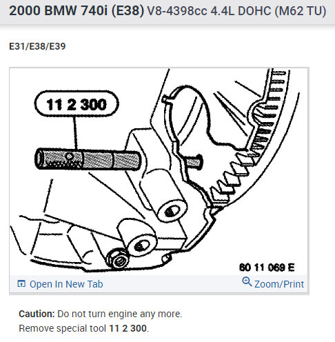

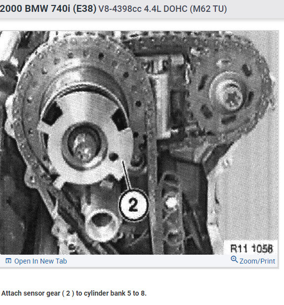

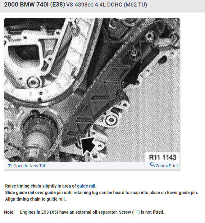

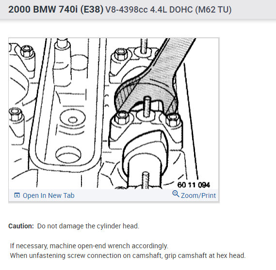

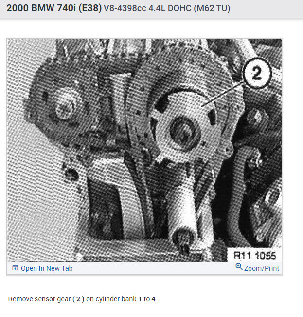

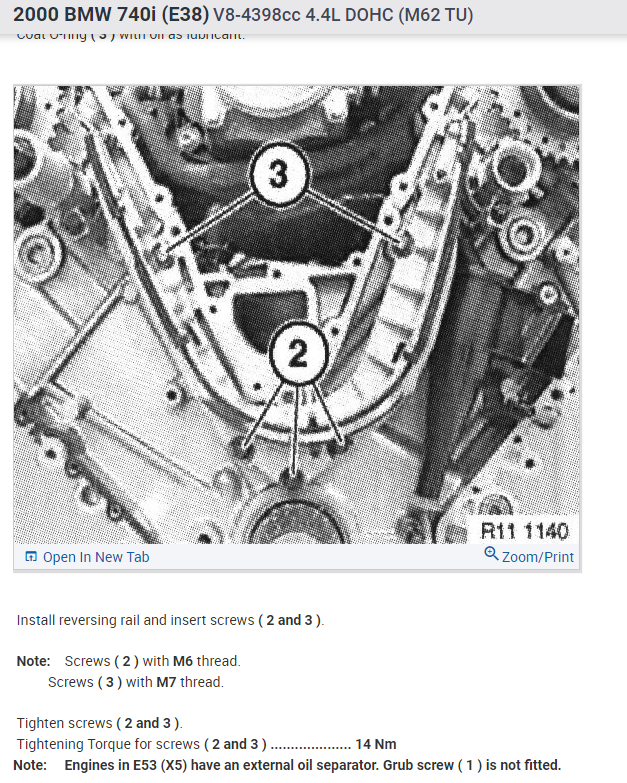

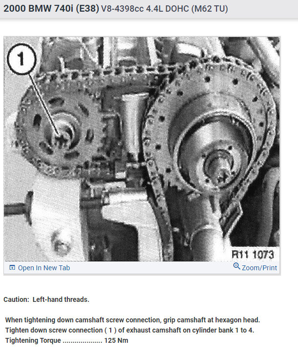

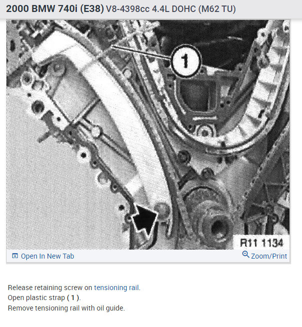

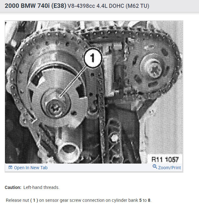

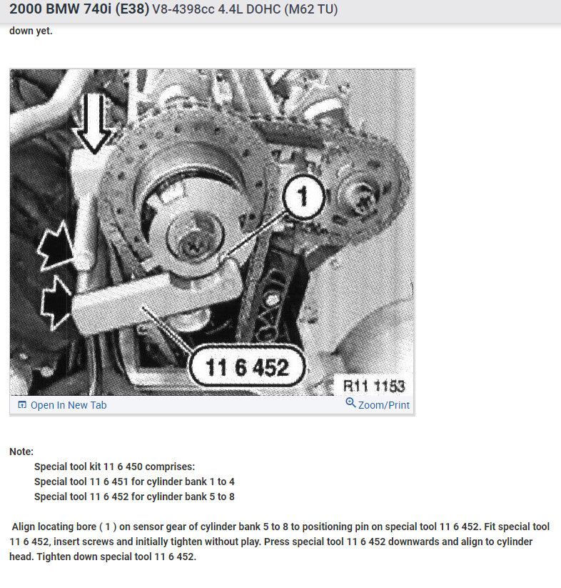

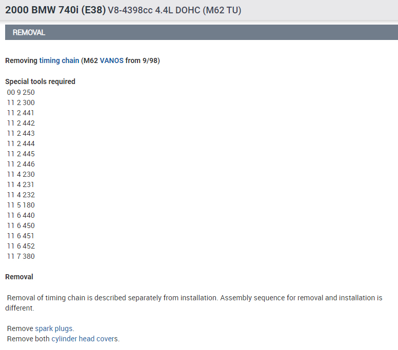

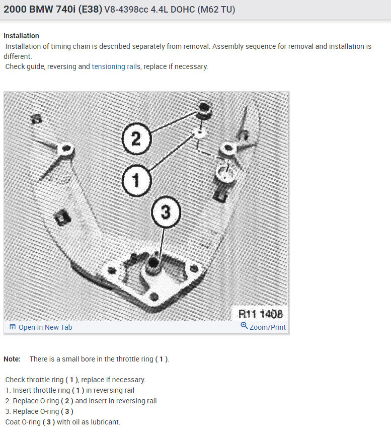

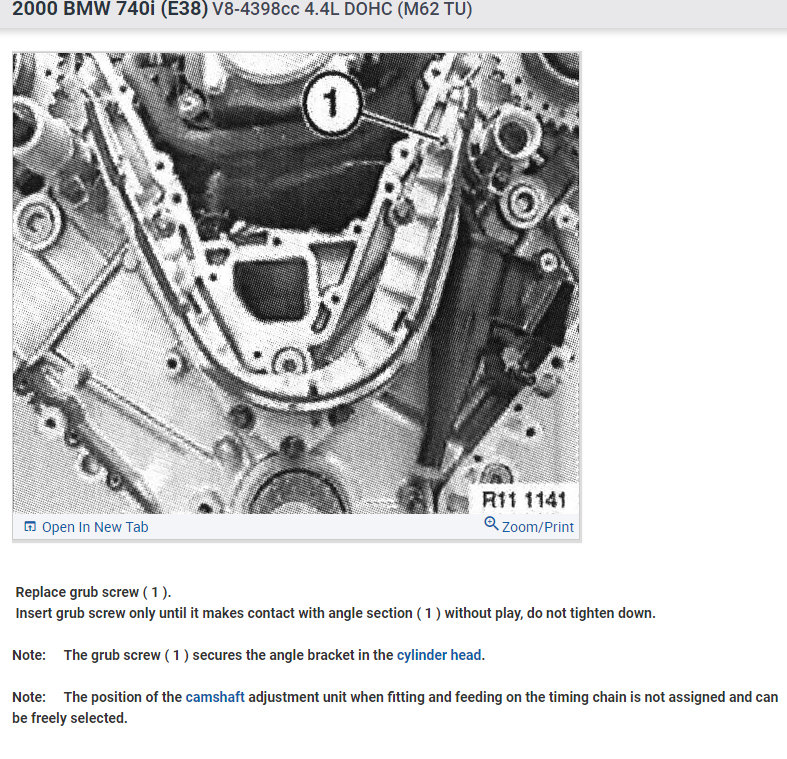

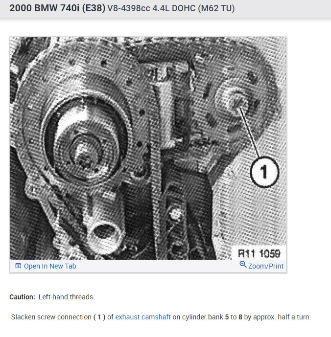

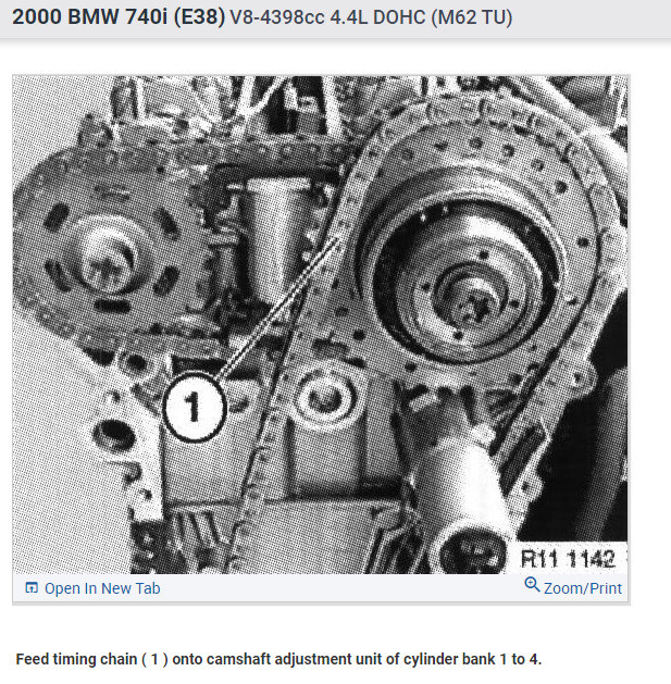

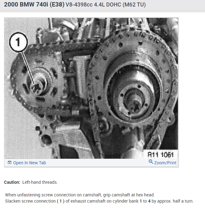

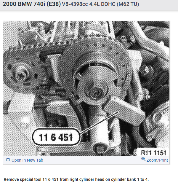

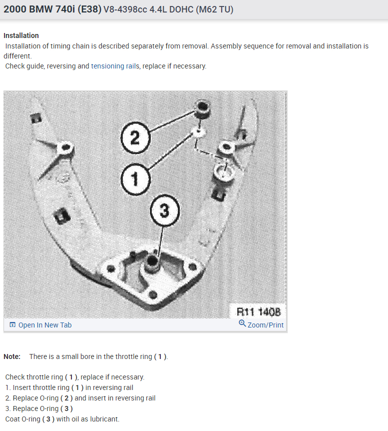

To replace the timing chain on this 740 you will need few special tools to get this doe effusively.
I have attached the complete timing changing replacement diagrams including all the markings and torque specifications as well as what special tools you might need.
