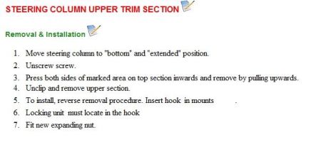

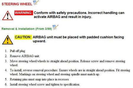

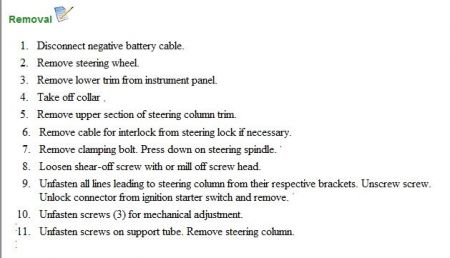

Thanks for the answer on my mysterious electrical issues. I have the exploded view of the steering column, but I still need to know about any special tools, procedures and general R & R. Thanks again!
