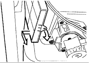

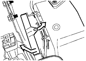

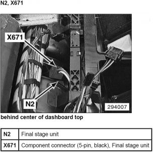

where is it located and procedure for replacement and location of two sm cabin filters left and right below dashboard.....thank you david

Final Stage Units for Integrated Heating and Air Conditioning (IHKA)

The pollen filter inserts are located on either sides of the Air Flow Control Box.

Replacement of the final stage unit is not something you are going to want to take on unless you have the tools and the time.
