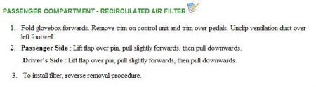

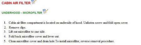

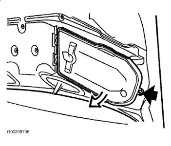

changed larger filters under hood but dont know how to replace smaller ones can you help

The interior filters are easily replaced. The passenger side filter is accessed through the drop down panel, just remove the two plastic rivets and pull the panel out and there is a door that holds the filter, pull it down and replace it. The drivers side is a bit more work. Pull the panel directly above the pedals and the door pulls down like the passenger side.
