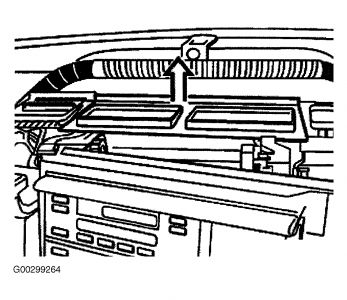

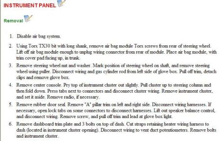

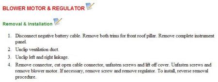

i would like to know where it is located. I know its under the dash board but where?

Thursday, January 28th, 2010 AT 8:46 PM
