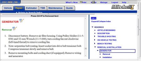

how to remove a alternator from 1995 bmw, 740i ?

See below
https://images.2carpros.com/forum/automotive_pictures/12900_alty_bmw_1.jpg
