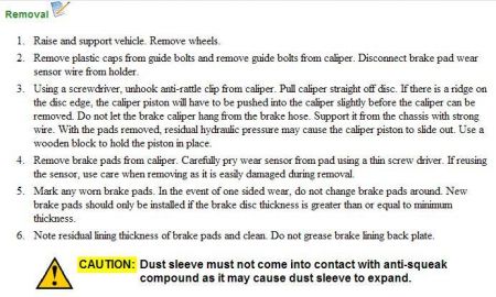

I already donated, but no one will help me. I cannot find the bolts to replace the front brake pads. Please help!! I ALREADY DONATED!!!!!!!!!!
Sep 16, 2009 at 8:27 AM
BLUELIGHTNIN6
  • 16,542 POSTS

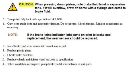

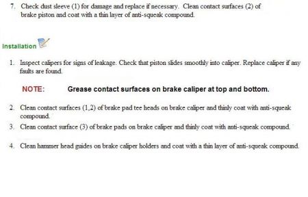

Hello and thanks for the donation! Here are the replacement procedures for your vehicle's front brake pads. Let me know if you need further assistance with this repair..
