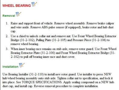

How to replace

https://images.2carpros.com/forum/automotive_pictures/261618_Noname_2330.jpg
