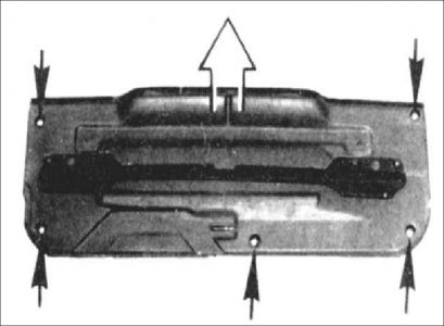

i wat to know how to replace heater blower
Feb 20, 2009 at 7:02 AM
IMPALASS
  • 3,112 POSTS
Hello - So I can check for any TSBs, please tell me if your model is a GLE, GXE, or SE. Also your engine size in liter. Here is the info you requested. BLOWER MOTOR Removal & Installation 1. Disconnect negative battery cable. Remove cooling system expansion tank. Unclip wire harness protective cover on firewall. Cut plastic wire ties as necessary. 2. Remove 5 retaining screws and remove bulkhead splash shield. See Fig. 10 . Unhook blower motor cover retaining strap and remove cover. Disconnect electrical connectors from blower motor. Pry up on blower motor retaining strap and remove strap. Remove blower motor from cowl opening. 3. To test blower motor, see BLOWER MOTOR TEST under TESTING. To install, reverse removal procedure
