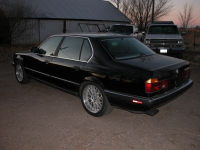

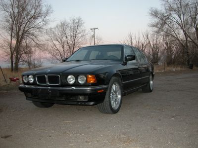

Dr. Hagerty is Right!!!!! I did the foolish mistake of putting 18 inch wheels on my 1990 750IL, the car looks Hot, but it rides like a piece of @!*#, I cut me out some spacers on my buddies computerized plasma cutter but the front tire still rubbed a little bit on the back of the Fender. I believe BMW spends more money on designing wheels for there cars, then Ford spends on designing their whole car.
