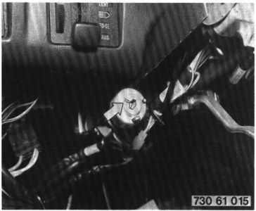

How do you remove ignition switch on a bmw 735i
Monday, August 16th, 2010 AT 9:48 AM
  • 75,992 POSTS
Steering Lock/Ignition Switch, Removing and Installing :
*Disconnect minus lead at battery.
*Remove and install trim lower section. See: Body and Frame Interior Moulding / Trim Trim Panel Service and Repair
https://www.2carpros.com/forum/automotive_pictures/12900_i1_3.jpg
*Unscrew stud screw and pull out ignition switch.

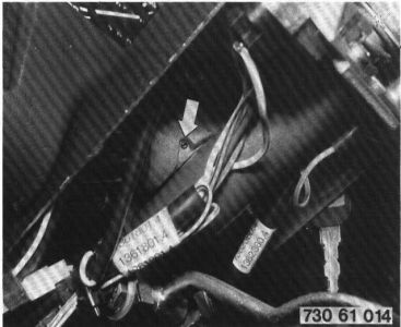

Installation Note !
https://www.2carpros.com/forum/automotive_pictures/12900_i2_3.jpg
*Turn back ignition key all the way.
*Position ignition switch at 0.
*Note mark and install ignition switch in this position.

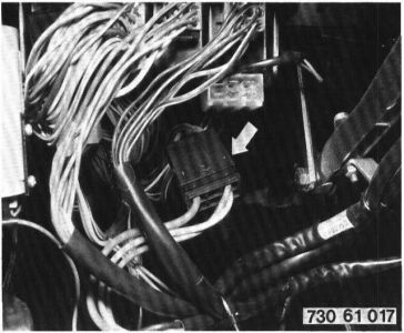

*Loosen wire straps.
*Disconnect single plug.
*Pull off central plug and remove ignition switch.
