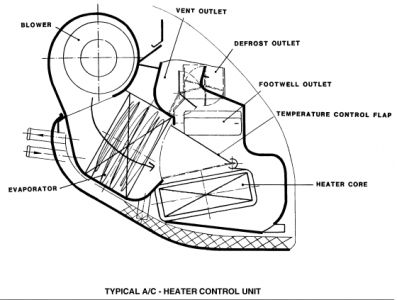

How do I remove the heater core in a 1986 BMW 735 for repair?
Jan 12, 2010 at 9:43 PM
  • 75,992 POSTS
Removal: 1.Remove instrument panel trim and fresh air grille. 2.Remove Airflow Control Box - A/C.
https://images.2carpros.com/forum/automotive_pictures/12900_heatercorebmw_1.jpg
3.Disconnect condensation hoses. Evaporator/Heater case can now be separated and core removed. 4.Reverse procedure to install.
