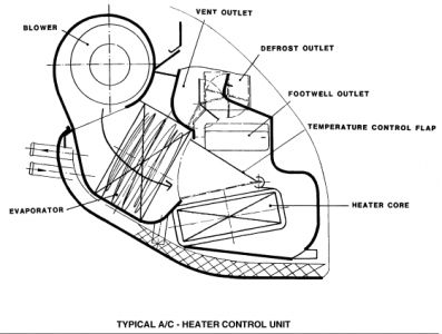

How do I get the heater core out from under the dash? I have already taken the center console out, but still I can't get the core to come out.

Removal: 1.Remove instrument panel trim and fresh air grille. 2.Remove Airflow Control Box - A/C.
https://images.2carpros.com/forum/automotive_pictures/12900_hc_1.jpg
3.Disconnect condensation hoses. Evaporator/Heater case can now be separated and core removed. 4.Reverse procedure to install.
