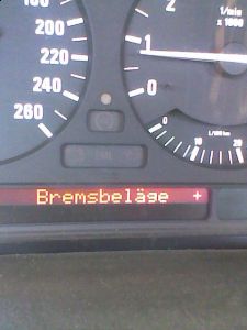

how i can change my car language from germany to english

how to change the language to the english

now i know how to change the language
1. Turn the ignition to position 1.
2. Hold the right button down for 10 seconds. Then the next language will appear.
3. Repeat this procedure untill you have the desired language.
