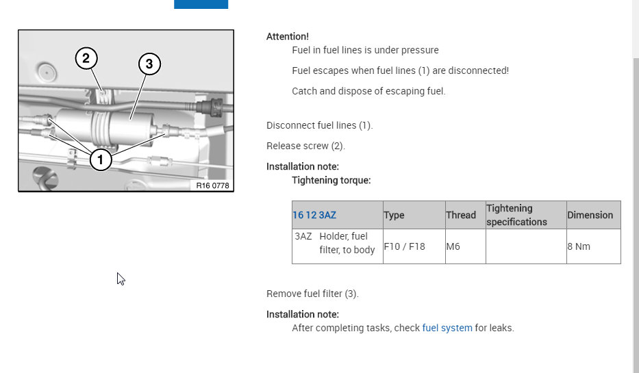

7. is it recommended to change fuel filter, oxygen sensor, replace valve cover gasket or bushings, differential fluid.

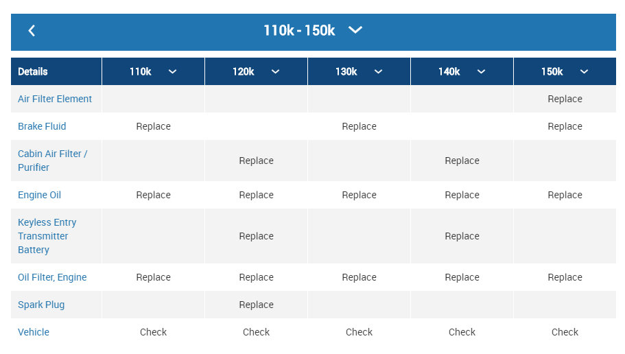

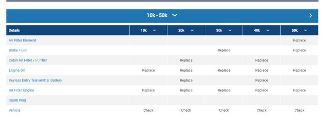

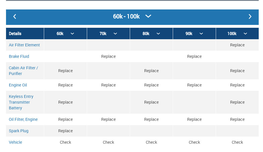

4. Cabin air filter - Listed in the tables attached.
5. Engine air intake filter - Listed in tables attached.

7. Is it recommended to change fuel filter - is not listed but should be changed every 30,000 miles.
replace valve cover gasket or bushings, differential fluid - Only when it needs it.
