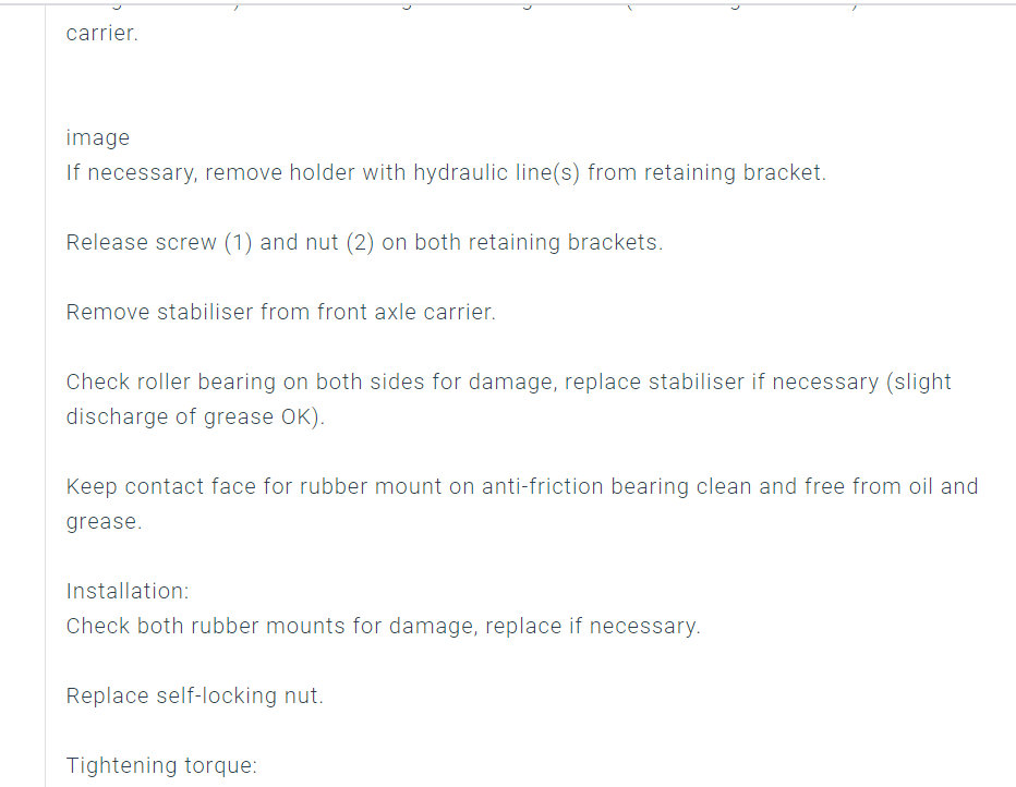

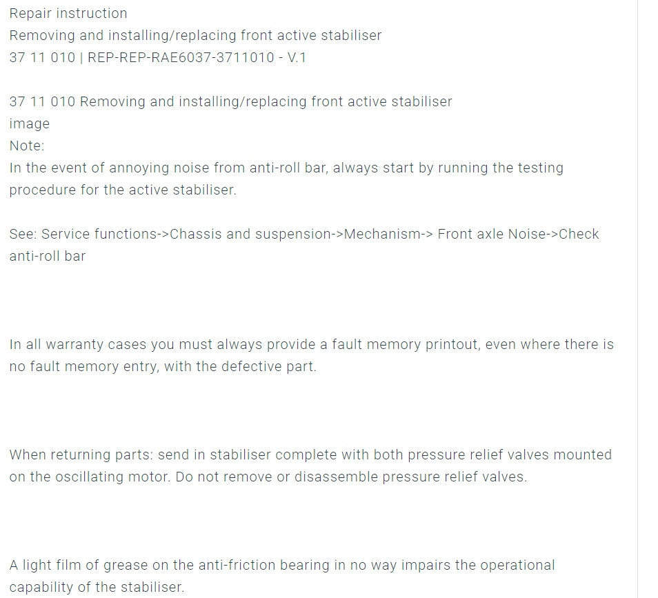

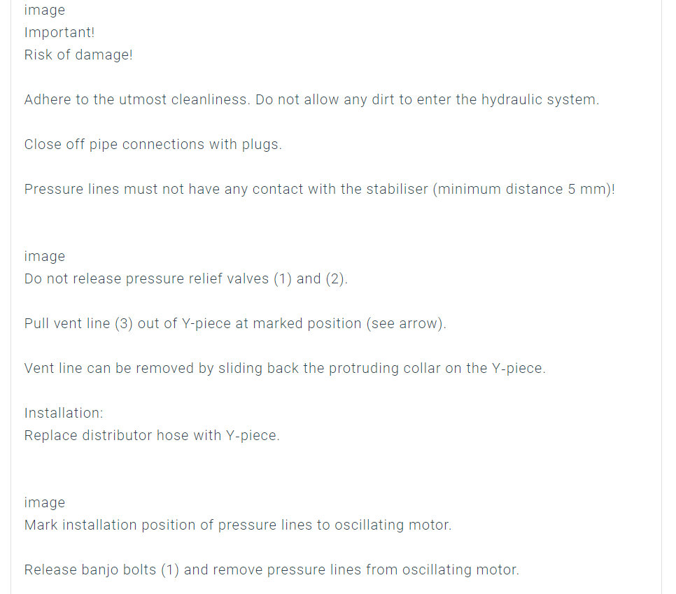

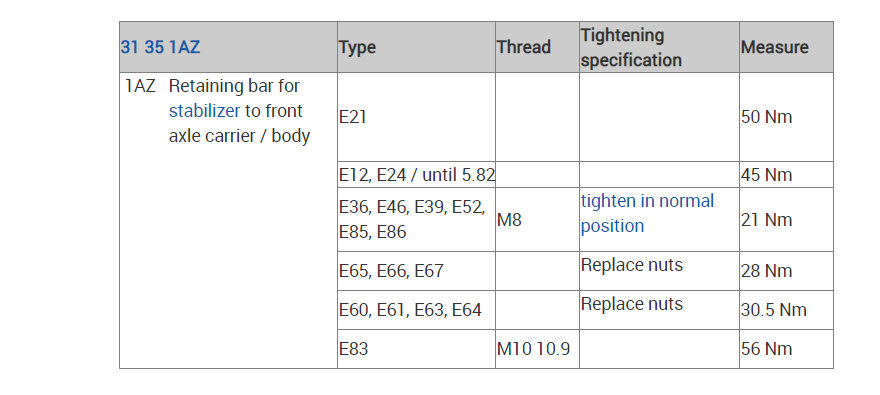

I have had this vehicle for 1 year, it started making a growling noise after a front brake job that BMW performed. After taking it back several times they are now telling me that the sway bar needs replacement?
