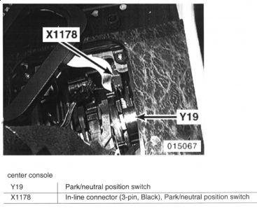

where is the nuetral safety sensor lacated on my car?
Mar 21, 2010 at 12:13 PM
  • 75,992 POSTS
Neutral Safety Switch Center Console
https://images.2carpros.com/forum/automotive_pictures/12900_nss_5.jpg
https://www.2carpros.com/kpages/auto_repair_manuals_alldata.htm
Mar 21, 2010 at 12:20 PM
MLCBMW

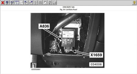

The 540i I have is a 6 speed manual trans, I believe this picture is of an automatic trans. I cannot find the sensor at this location in my 1998 540i. Help!
Mar 22, 2010 at 6:53 AM
  • 75,992 POSTS
If you're looking for a switch/sensor that prevents starting the engine without stepping on the clutch pedal its called Electronic Drive Away Protection Control Unit that's located in the left kick panel-see below
