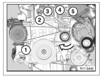

how do I fit air conditioning belt on a 530d bmw?

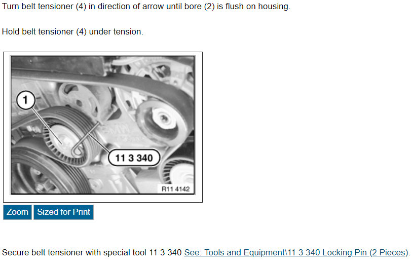

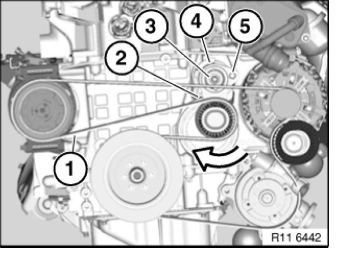

Here is a guide to show you what you are in for when doing the job with the diagrams of what it will be like for your car (below).
Cheers
