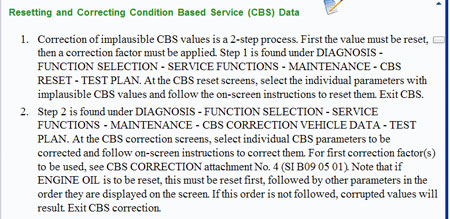

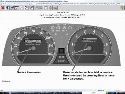

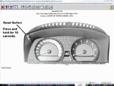

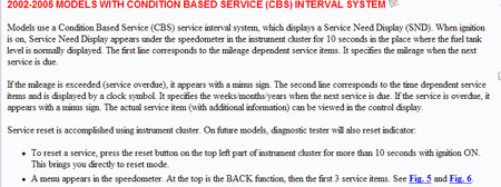

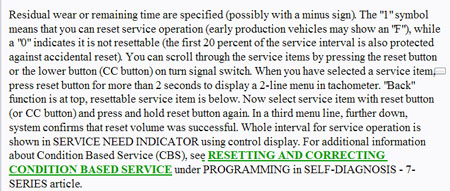

I have a 2004 530i just out of warranty and would like to know how to reset the service computer after an oil change other than taking the vehicle to the dealer. Can anyone help me?

Merlin 2021 you are pure magic! Just came back from my car and I'm very very happy to report back that I was able to reset the service computer with your guidedance. Thank you so much!
