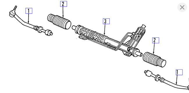

Car listed above is a 528i. My steering wheel has a big clunk and steering drift when the wheel is straight. The problem disappears when I turn either left or right. The issue occurs at all speeds. I replaced the front struts, the tires are less than 4 months old.

Good morning, and thank you for your help. I'm attaching a video of the issue. After driving it again, I can say the sound seems to come from the passenger side of the car. The issue doesn't seem to appear until I travel over 30 mph. And it is in the spot where the steering wheel is straight, but pulls toward the right (alignment issue which was present when I bought the car, and not when this noise started). This issue only started after I replaced the struts (quick strut assembly, with new coils and top mounts).

Okay, I attached a picture of the steering for you.
Check the wheel for play side to side with it jacked off the ground. It sounds like either the inner tie rod end or the out may be worn out.
https://www.2carpros.com/articles/tie-rod-end-replacement
Also, check and make sure the steering rack it self is not moving as well.
If the mounts are worn, it will cause this issue.
