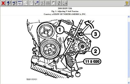

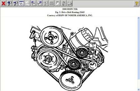

need fan belt routing?
Apr 28, 2008 at 7:11 AM
  • 75,992 POSTS
See below
https://images.2carpros.com/forum/automotive_pictures/12900_belt1_1.jpg
https://images.2carpros.com/forum/automotive_pictures/12900_belt2_1.jpg
Thanks to Rasmataz from Dr. Hagerty
Apr 28, 2008 at 7:23 AM
ANDREMCGAUGHEY
What is the route of the belts when replacing them?: Which one goes on first?
May 20, 2020 at 1:35 PM (Merged)
DOCHAGERTY
  • 9,606 POSTS
The A/C belt goes on first and then the water pump/power steering pump/alternator belt. The route is obvious for the A/C. The water pump,alt,P/S belt, starting at the top pulley for the water pump, go under the deflection pulley then over the alt. then around the P/S pump then around the crankshaft and then to the idler pulley and then to the water pump and that is it.

FLYIII
i need thw serpentine belt diagram for my car 1998 528i
DOCHAGERTY
  • 9,606 POSTS
I can describe the routing for you. Starting with the water pump pulley,off the top of that, then it goes under the deflection pulley, over the alternator, down to the power steering pump, along the bottom to the crankshaft pulley, around the tensioner pulley and to then back to the water pump.

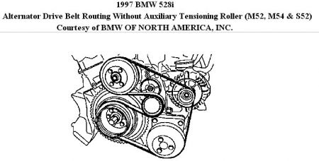

FLYIII
1998 BMW 528 Engine Size unknown Four Wheel Drive Automatic 56000 miles
I need the serpetine belt diagram for my 1998 528i please

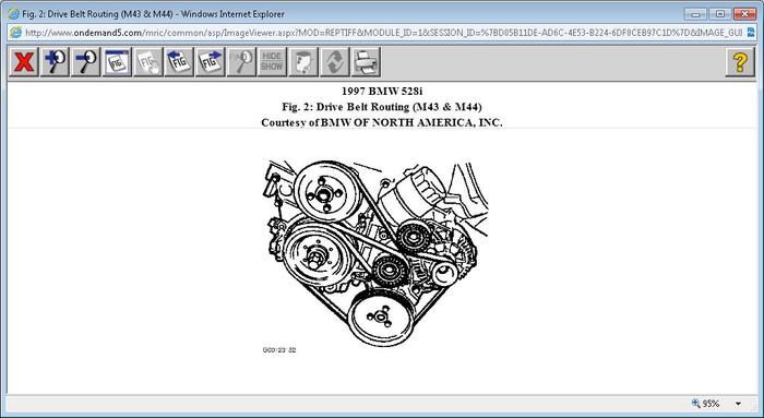

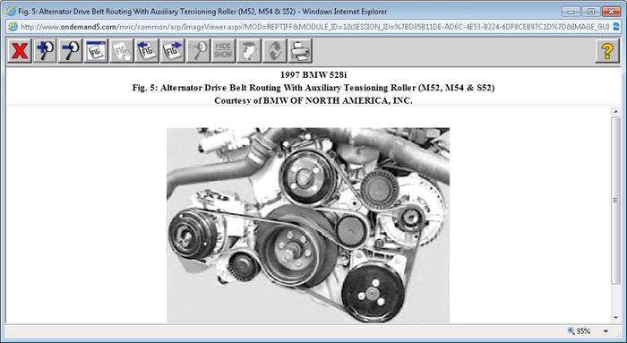

I need the belt routing diagram for a 1997 528i with a tension pulley.
SATURNTECH9
  • 30,869 POSTS
See if one of the diagrams i posted is what you have.
