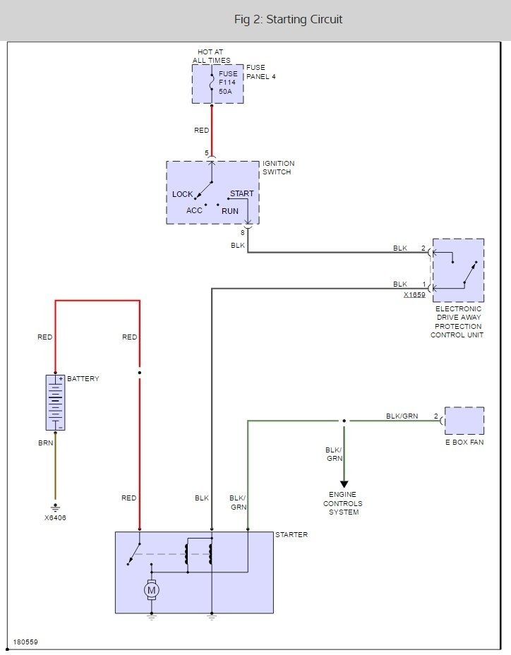

my 1998 bmw 528i wont start i check the starter and it good put new connectors on starter but still don't even click...need to kno where would the starter relay be on my bmw?

the only relays that are related to the starter are the closed circuit cutoff relay (located behind glovebox) and the overload protection relay (located in RH side of luggage compartment)

I have a similar problem. I bought this car from an individual. The battery was dead. I managed to charge it.The engine turned but the fuel pump wasn't working.I bought a fuel pump relay from autozone.I put it in. It had a dead short in it.I got it back out as fast as I could. Now the starter won't turn. Maybe an overload relay ?

There is no starter relay except for the solenoid on the starter itself, there is a driveway safety module that could be bad, here is a wiring diagram and a guide so you can do some testing.
Best, Ken
