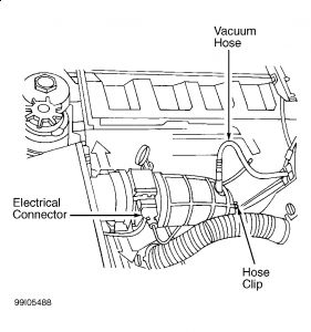

Where is the sensor locate and can i do it.

Pretty simple procedure. Located on the air intake
https://images.2carpros.com/forum/automotive_pictures/261618_Graphic_77.jpg
disconnect the sensor connector disconnect vacuum line (if equipped) disconnect air hose clip and clamps on intake filter housing remove intake hose with MAF sensor installation is reverse
